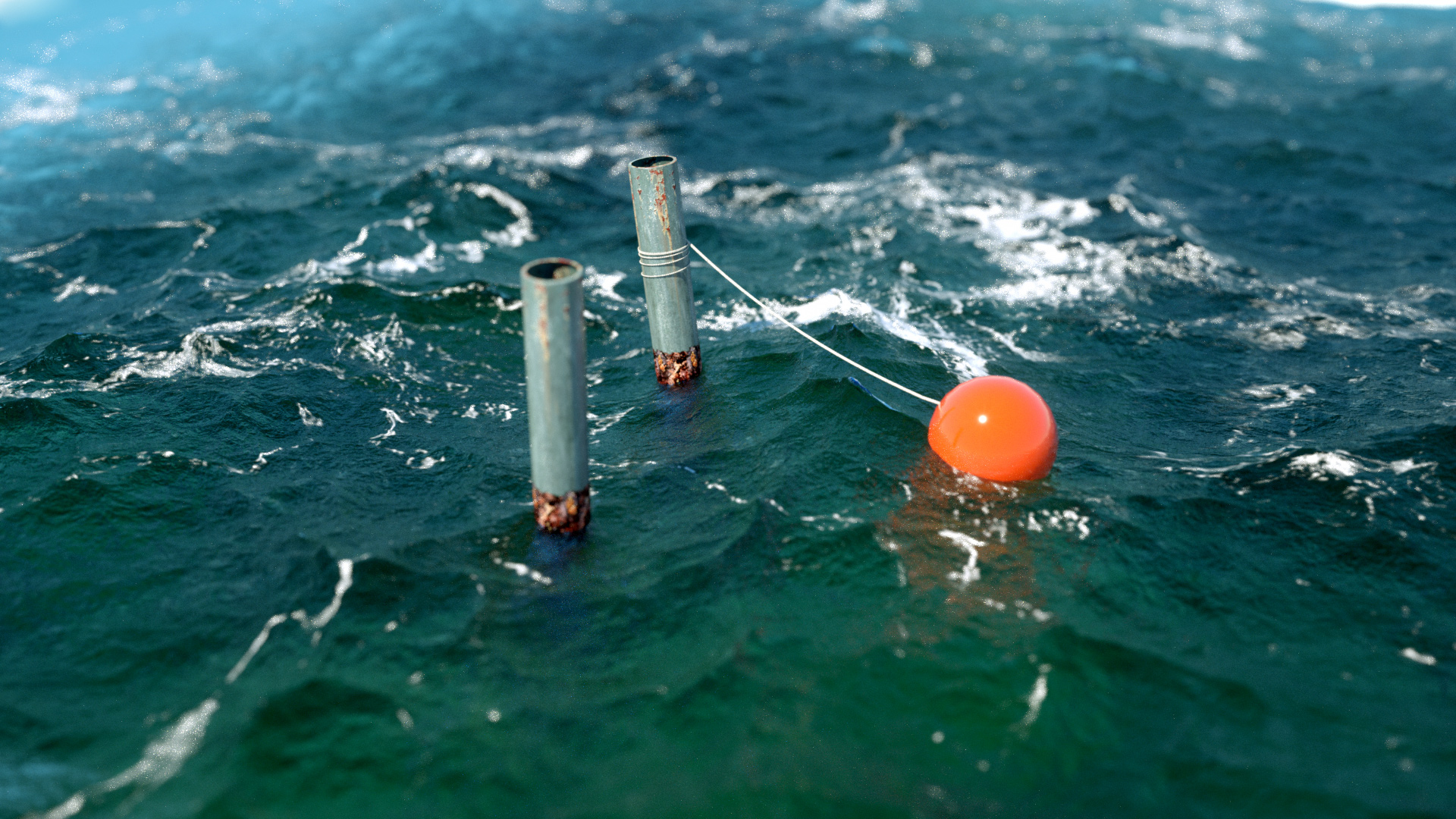

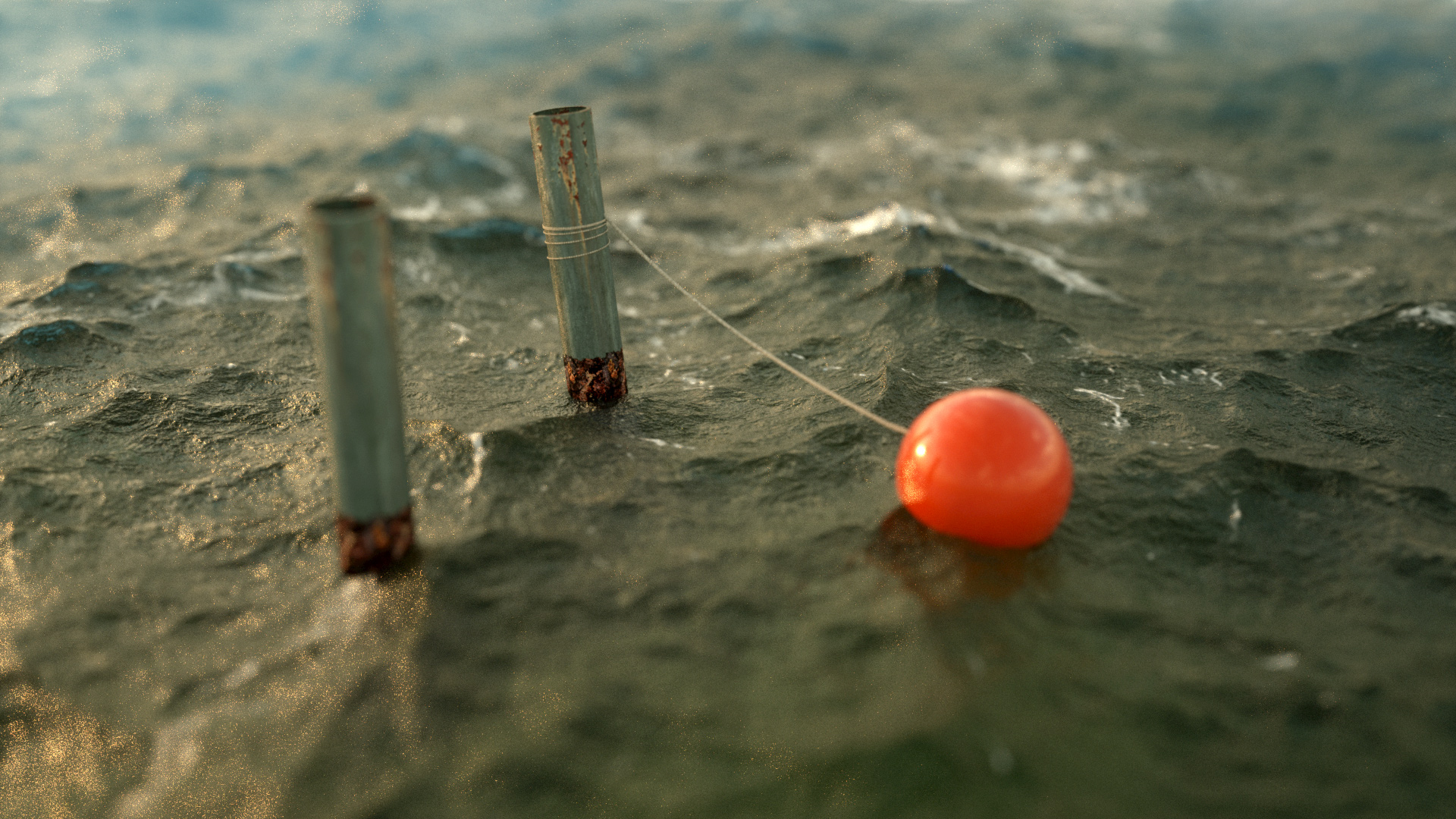

I did render some Stills with different lighting setups (sunlight and hdri), and I think it looks really amazing realistic, even with DL kernel.
But there is some hotpixel problem with the ocean material, because of the bump channel and the turbulence. Any idea how to get this fixed without loosing realism? (beside hotpixel removal, which reduces details and sharpeness)
Sunlight
Sunlight
HDRI
HDRI

How long are you renders at the moment?
Hot pixels can be removed using external tools in Photoshop for example with reasonable success. Sometimes better than the built in hotpixel slider. But you will typically degrade the image.
Sometimes the only perfect solution is to simply cook for longer, which i understand may not be feasible for an animation. I guess it's the nature of the beast when dealing with unbiased path-tracing. Hoping the Octane team can look at improving this in future whether by noise reduction algorithms or enhancements the the kernels in areas of extreme bokeh and highlights...

Not sure how to get rid of all the fireflys myself. "Luckily" compression from vimeo kinda hides it.
I let my scene cook for 4 minutes. which is actually much higher than I would expect from a scene like this. Maybe just lowering bump strength would help allot?

Hi JessicaVines and Bulwerk,
the Rendertime for each Still was about 8-10 Minutes I think (1000 maxsamples in HD 1920x1080) with 1xGTX780Ti and 1xGTX580. Didn`t turn on my turbobox for that, so I should get good enough results for animation with all GPU power On)
In my experience the fireflies happen in bright reflective areas when using bump mapping, and therefore it increases rendertime a lot to get clean images. Sometimes it never gets clean, for certain lighting situations.
Removing fireflies in Photoshop (with Imagenomic Noiseware for example) doesn`t work good enough without degrading and flatening the image and loosing lots of detail (at least for those stills here). Massive use of the hotpixel slider in octane also degrades the image details.
To lowering the bump strenght helps with the fireflies and the rendertime but also ruins the realism. In fact this scenes organic look lives from the bump mapping of the ocean water material. Try to deactivate the bump mapping and you will see that all the nice surface details are gone.
Maybe and hopefully we see some improvements with octane 2.0 and the displacement capabilities, which might be even a better way to achieve the water surface, than doing it with bump mapping.
But there is definetly something going on in the renderkernel, that increases fireflies in certain situations (expecially with bump mapping and glossy or spectral materials), that hopefully can and will be optimized.
