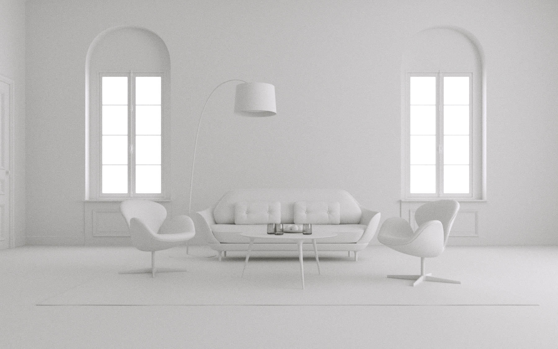

For example I prepared this one to find out if portals could be useful, even for rooms with bigger openings:
This is the scene. A simple room with three windows and only lit by white environment.
PT9 With Portals 1000s/px 6,8s/s 5min
PT9 No Portals 2100s/px 14,3s/s 5min
PT9 No Portals 1000s/px 14,3s/s 2min20
This is a 200% crop

nice one, this looks very usefull, this should be on some sort of wiki page, or a sticky thread
- and apparently the samples/s doesn't mean much, speed, but not divergence
- so the portals actually work well now? - too bad I'm still on 1.2 because of old scenes..
