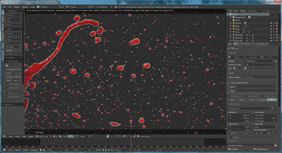

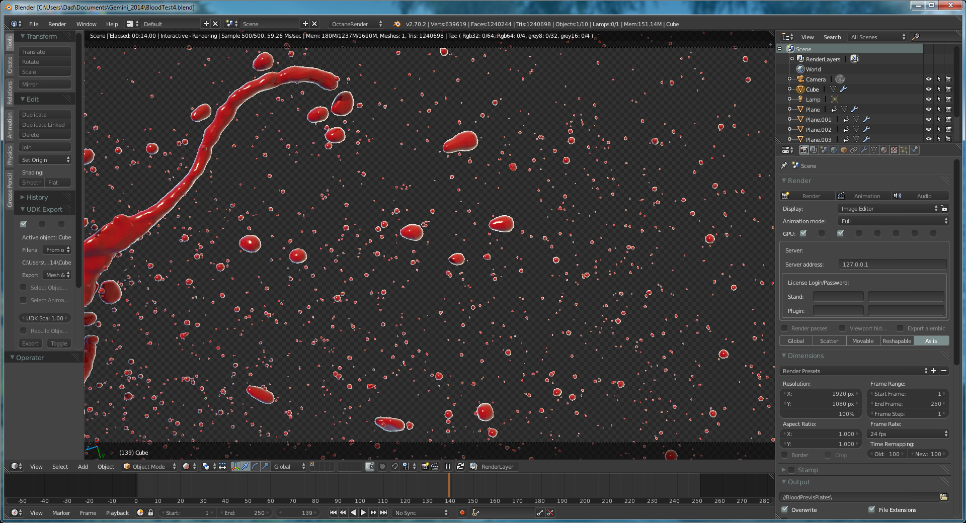

I have a fluid simulation that I initially tried to do as an alembic export, as the rest of the objects for the shot were rendered as such via movable proxies. When I tried to do the same for the fluid simulation layer, the imported scene contained all objects in the layer aside from the fluid simulation (domain object). After a few tries I gave up on alembic and decided to render via the plugin within blender. If I switch viewport to Rendered mode, I get the following:
If I then tell it to render a frame, I see a few status messages regarding data being sent, refreshing server, etc. but the image never shows up. I've tried several times by changing render mode and no luck. I'm at a loss as to why rendered mode for viewport would work just fine and not an actual render. Any thoughts as to what I might be doing wrong?
AMD-1100T 6 core, GTX-590 & GTX-480 1.5GB, 16GB 1600MHz RAM, 1TB WD 6GB/s, Win7 64bit, Blender 2.68a for Octane 2.2, Octane 1.20, Blender/Octane Server 2.2
You can't be in render mode in the viewport and do a full render at the same time. If you switch to another display mode in the viewport you should be able to do a full (F12) render. If not than something else is wrong.

Good advice, but sadly that's not it. There's a crap-load of tri's so I figure I'm likely just overwhelming the system. But it just seems odd that the same doesn't happen when the viewport is in render mode.grimm wrote:You can't be in render mode in the viewport and do a full render at the same time. If you switch to another display mode in the viewport you should be able to do a full (F12) render. If not than something else is wrong.
