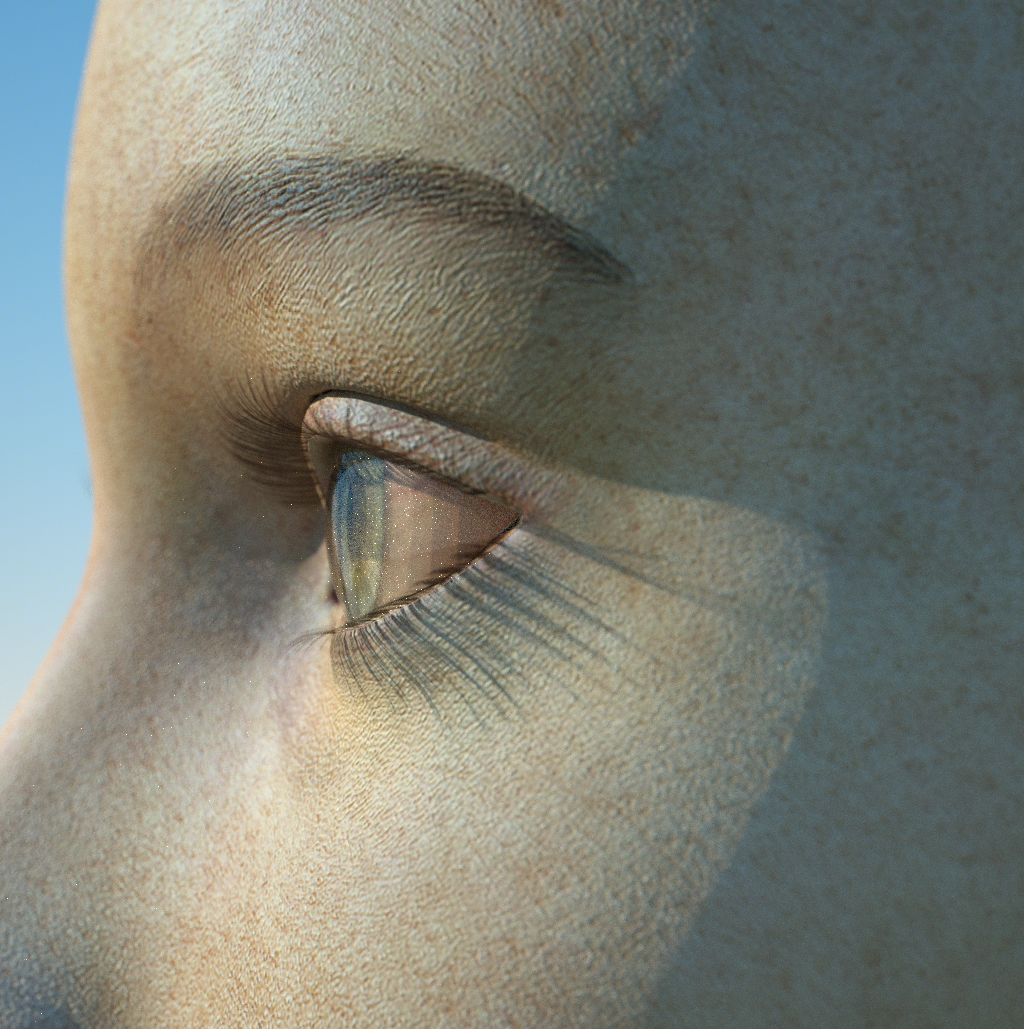

Been desperately trying to achieve an effect like the one in the photo below.
In reality - when viewed from the side - the iris will refract and "fill out" the "eye surface".
This is where the problem comes in: All DAZ figures are using an "eye surface" or "eye reflection" material that is coplanar meaning, that it is not suitable for realistic refraction calculation, since it has no volume and light travels only through the surface but not the volume
(a necessity for realistic refraction if I remember correctly).
The result of a Genesis 2 character pictured in the attached image, with proper light placement and the material settings as shown in OctaneRender, obviously do not deliver a realistic result.

thanks for your try - unfortunately this is not the result I'm aiming towards.
(ONly had the time to answer your question now)
The Iris is not bulging in the reflection of the eye surface / Cornea like it does in the photo.
As the matter of fact I found out that the Cornea material can greatly impact the result I'm achieving with this.
Check this link to see how it should be http://forum.runtimedna.com/showthread. ... post147531
