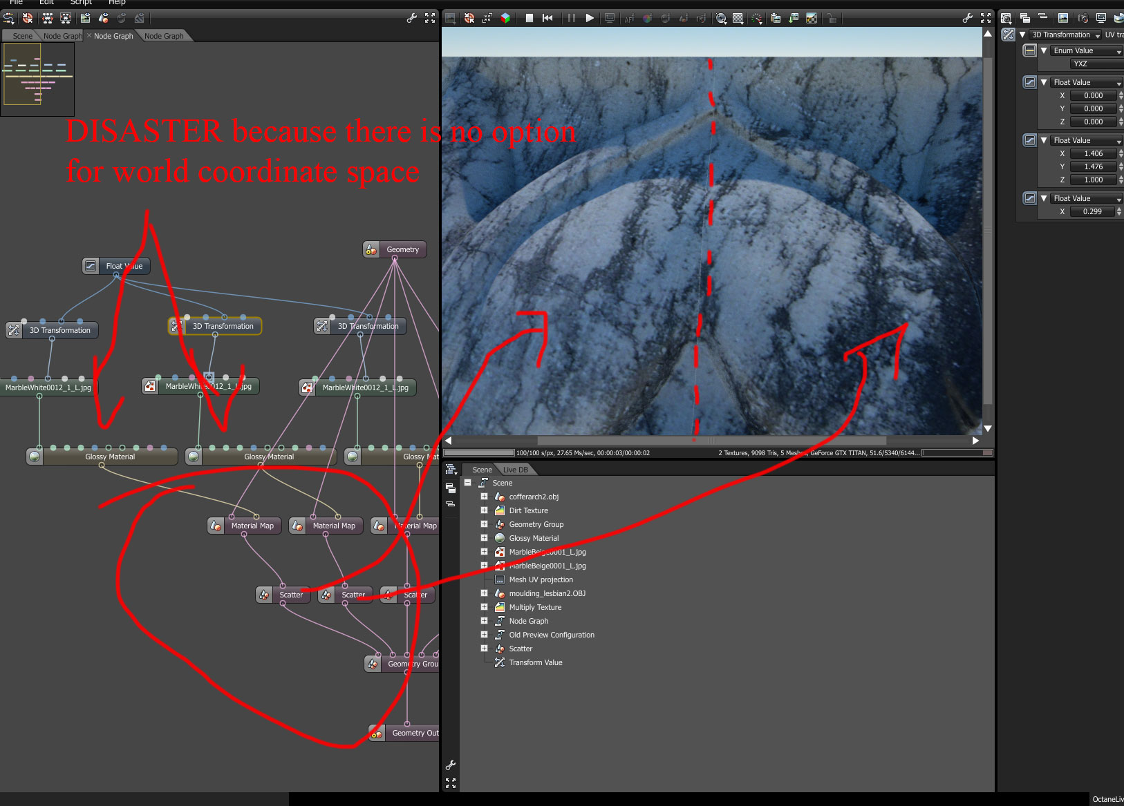

I am not sure. I hope it will but let me clarify that all I need is the same option (WORLD SPACE) as we have in the box projection and all others but not in the mesh UV projection.
For animation purposes (as matej said there should be another solution, but the WORLD space is all I need).
On the screenshot you see how tremendous work I have to do to move the texture on a consecutive instance. First I have to split scatter data into separate scatter nodes - this is sick. Then I have to assign an independent material map to each of the scatter nodes. Then the same material and texture has to be multiplied and then I can move texture using transforms. And this is still not working precisely.
So please - add this WORLD SPACE option to the mesh UV projection.

The mappings, like box or spherical, will get world or object coordinates and may do some additional transform on it. For UV coordinates there is no object space or world space option, because they are just coming from data stored in the mesh.
How does ZBrush handle these instances? Usually if you have an UV mapped object, the texture has to have some distortion to match the UV map of the object. Maybe the UV map minimizes this distortion and you can apply a random offset to the texture, but that's something completely different than world space coordinates. Can you show the UV mapping of the moulding and the texture image you're applying?

roeland wrote:For UV coordinates there is no object space or world space option, because they are just coming from data stored in the mesh.
I understand. By "world space for uv mesh" I mean that origin of the texture for an obj, and all its instances (that are created with a use of a scatter node) are set to the same origin as the original obj. So the texture that is large enough could be continuously spread over many consecutive instances.
Imagine I have a large texture that I want to spread over 10 instances. When I choose "world space" in box mapping I can do it. I also would like to do it for a uv mapped mesh and its instances.
PS. In Zbrush I only create and UV map a geometry. I use sketchup and my and TIG plugin to create scatter data for instances.
If I make myself not clear please let me know.
