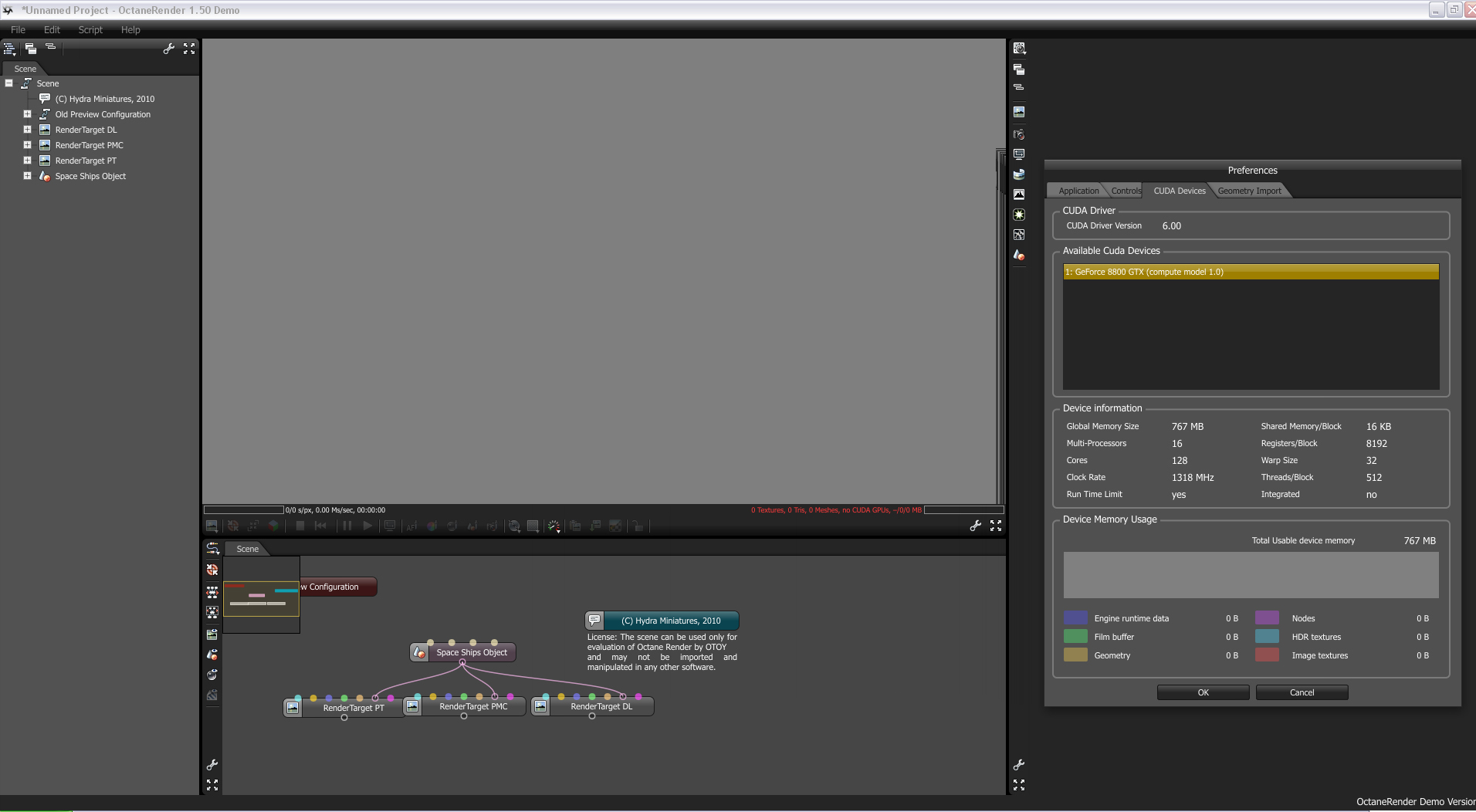

I just installed Octane demo standalone and 3dsmax plugin. Both of them I open ok I can see my GeForce 8800GTX in the Cuda Devices but I can't render.
In 3dsmax I open OctaneRender viewport and nothing happens.
In the standalone version I open a Demoscene and it's all grey. You can see attachment with preferences.
Any help is welcome.
Cheers

Hi there,
We don't support cards with CUDA compute capability 1.0 anymore. You can look up the compute capability (but not the performance) here: https://developer.nvidia.com/cuda-gpus Only 2.x and 3.x are supported at the moment.
cheers,
Thomas
