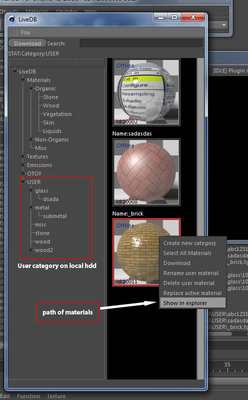

This is some explanation for USER category. This is visible for plugin and independent from standalone. You can put your materials here and not sending to internet. Just save to your hdd.kiwimage wrote: As an alternative solution, i was thinking to use the LIVEDB to make the bridge (standalone / c4dOctane) but i don't want to put my textures in public. (some are paid-for textures, some are messy or just project-specific and wouldn't benefit to all, it would cluster the public DB for nothing)

Oh, ok ! i didn't try to drag and drop, it's actually very easy to use !This is some explanation for USER category. This is visible for plugin and independent from standalone. You can put your materials here and not sending to internet. Just save to your hdd.
