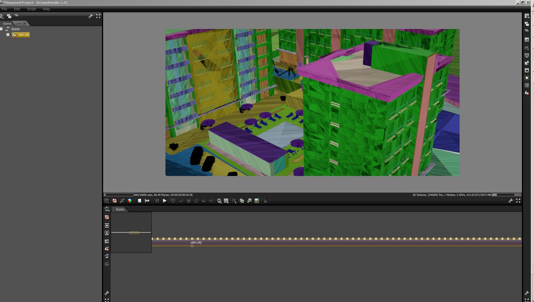

Hi everyone! I have a problem on imported object on Octane Standalone:(I exported 3dsmax as obj file.Then import in Octane standalone,But whole faces are stiped and there is no textures in the scene...How can i fix this problem???

Looks like the import scale unit doesn't match the export scale. Probably the 3D application exports the OBJ file in cm, but Octane is interpreting it as meters. You should open the settings for the mesh node and change the import unit to match the exporter.
Also check the kernel settings, it looks like the output of the info channel kernel, which renders false color images of various properties of the geometry.
