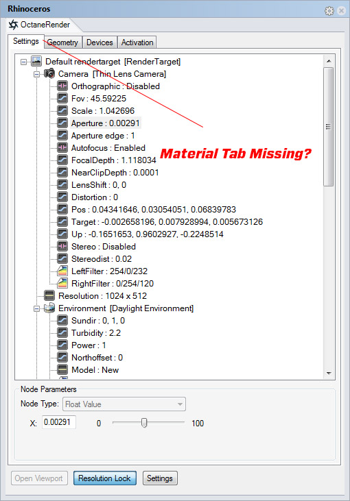

I just installed the Rhino plugin and I dont know if there is a setting I am missing or if there is something wrong with the install.
I dont have a Material tab showing (See below). How would you make the material tab in the Octane plugin visible?

There isn't a materials tab in the octane window anymore. You do all the octane adjustments in the rhino material tab, within the rhino material. Just right click on a material, and "change type" to octane then you'll see the octane options

Aah- I was confused by the user manual's mention of the material tab.
Thanks.
Yes - I urgently need to update the Rhino plugin manual to reflect this. My apologies.
