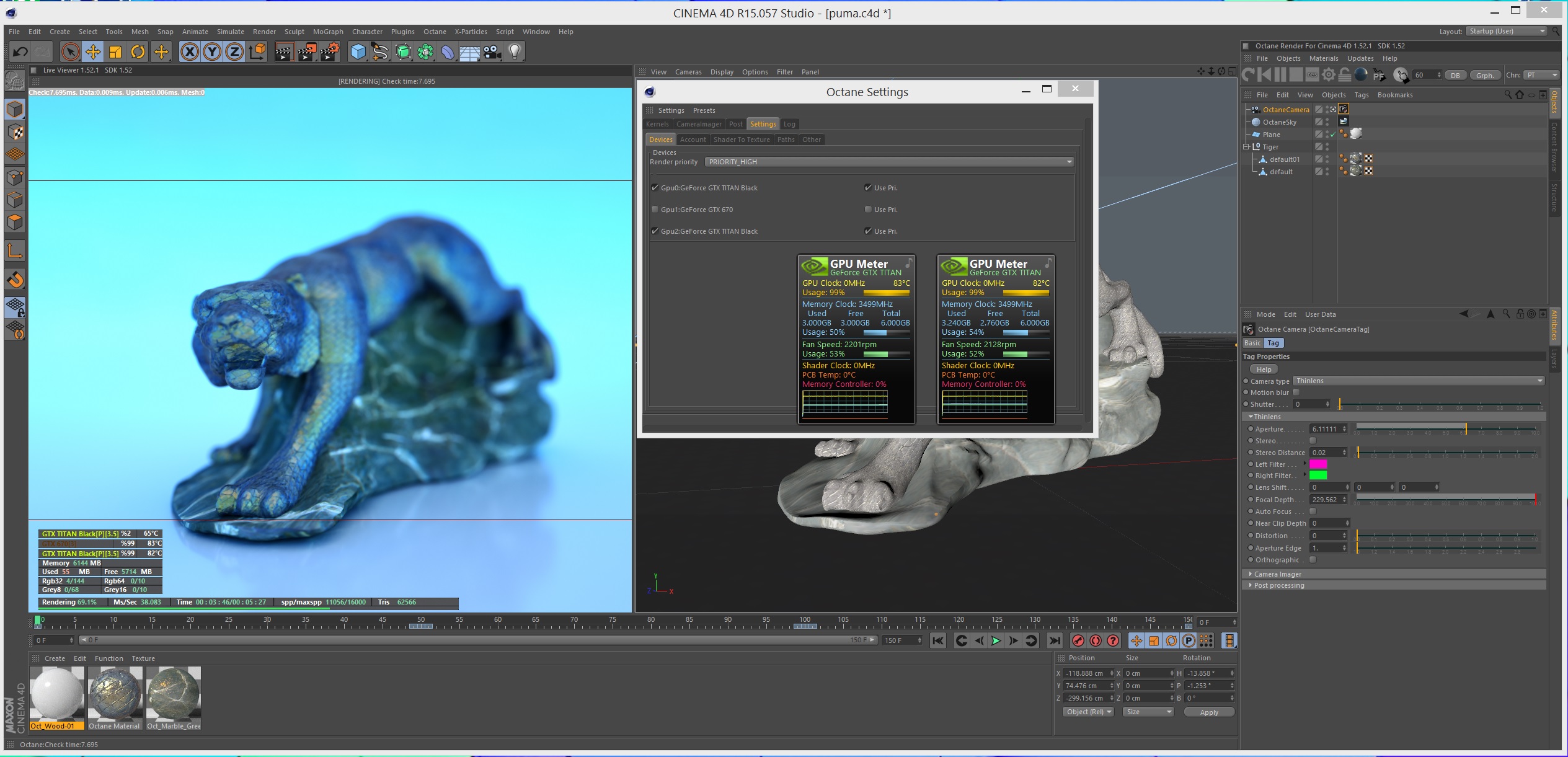

Ok I found the issue, the live viewer GPU info incorrectly displays for my 670.
So if you look at attached pic, even though the two titans are selected in settings and the 670 is not, in the live viewer info it looks like one titan is being use and the 670. With the windows gpu meters I can see both titans being used. Guess its a bug?
