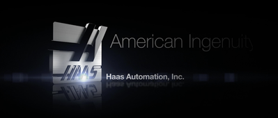

Would I be right to assume that limiting reflections to certain objects would not be possible? See the attached photo how the black reflection floor reflections the Logo but doesn't reflect the HDRI environment. In Cinema 4D you can do that through the compositing tag. Does this feature not carry over to Octane Render?
I don't know how else to create the invite reflective floor without having the HDRI reflections effect it. Any ideas?
Limit Reflections to certain objects
not yet possible.you can use a environment which has big black are. Black part is facing to camera
