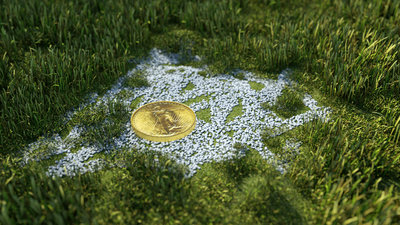

strange: one Object has no Shadow… (Coin) !?
lassinger
Posts: 125
Joined: Tue Jun 01, 2010 5:34 pm
i dont know why, but only the coin has no shadow….???!!!
what is that?
Thank You!

only way to put a objecttag and change shadow visibility

simpler than that, but curious…! ;)
i put the coin in the c4d hircharchie on top and: bingo… shadow is visible…
aoktar wrote:only way to put a objecttag and change shadow visibility

Your plugin version? There was a bug on visibility. This was occured on some very complex situations.

aaah, ok. ...yes, plugin...
