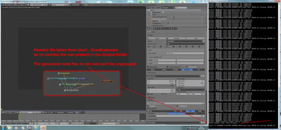

Well, before going to bed, I launched two exports of 5 frames of my animated tree.
They were both successful and generated an usable alembic file in the Output folder.
Then I launched an export of 990 frames. It required less time than my complex car animation, and after I slept 1 hour, it is finished :
There is no alembic file in the output folder.
The file in the user\...\livedb\alembic folder gives a node with NO PINs at all.
There is no log file generated.
Blender console says Wrong alembic file, size : 0 bytes, but the invalid alembic file weights 5.122 GB !
Sorry : nothing fixed. :roll:
I switch off the machine... back to bed.
JimStar
Posts: 3851
ROUBAL
Can you give me the scene where I can reproduce it?
