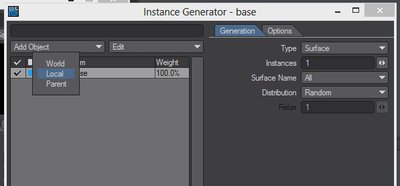

Hello,
How can I hide the master object of instances?
In lightwave render, it works if it turn off from scene editor, but in octane render, it shows.
Thanks!

Currently you can't hide the master object, you should move it out of your camera viewport, or make it very small, and instance it in "Local" mode.

Thank you very much juanjgon!!
