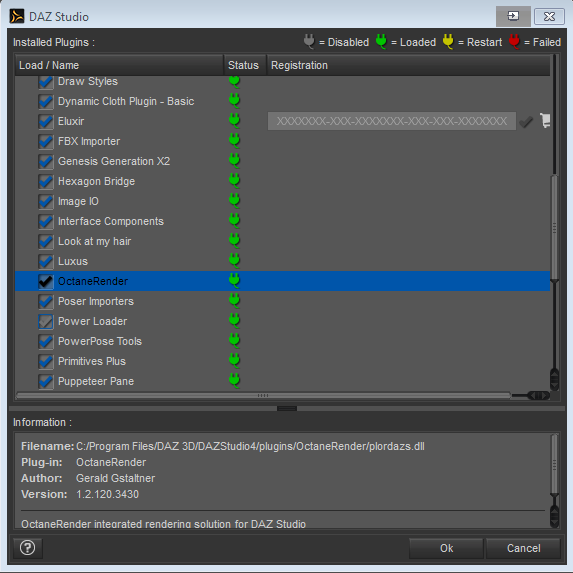

And since my plugin info looks like this for the same plugin in the same location:
I would reiterate that you should consider re-downloading, uninstalling, perhaps rebooting, and re-installing the plugin.
