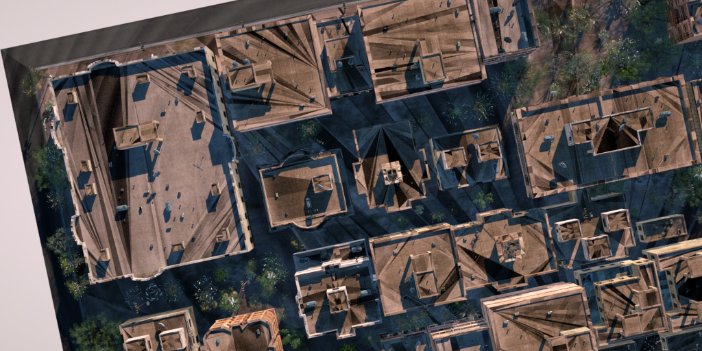

I am getting these weird triangles in my rendering, first i thought its because the model is in quad polys, I then converted it to triangulated model but problem is the same. When i render it with Lightwave renderer everything is fine.
weird triangles in rendering

Try tweaking Ray Epsilon and report back.
