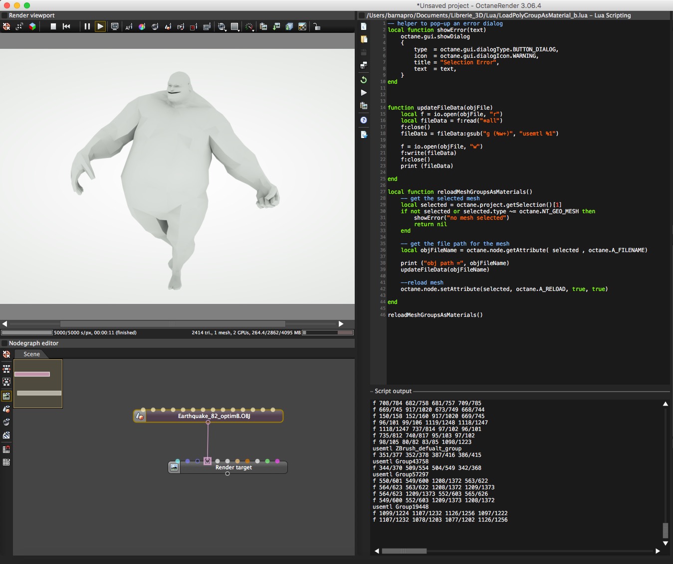

Posts: 10621
here is a revisited version of the script to make it works also with recent versions of OctaneRender.
You need to select the imported obj node and run the attached script, to have all the polygroups listed as material pins:
LoadPolyGroupAsMaterial_b.lua
(1.08 KiB) Downloaded 830 times
Basically, the script was not working with v2 or v3 because the octane attribute were called via ID number instead of name, and the id numbers have changed during versions.
