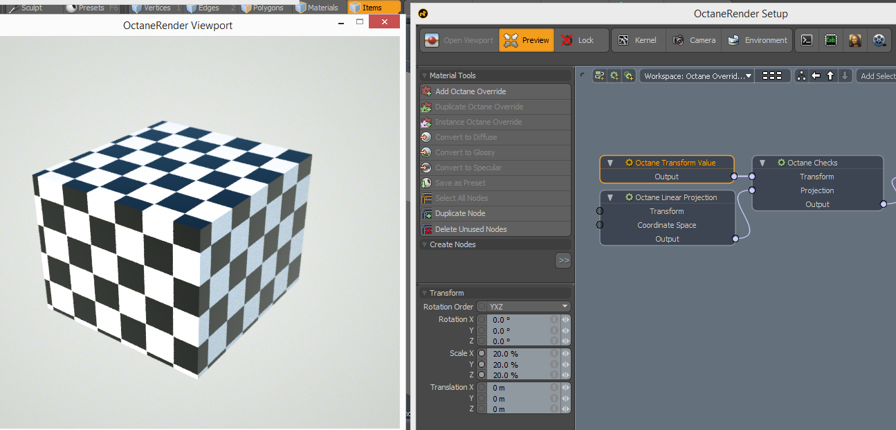

Just started a new test scene with a cube
Octane is rendering it ok, my previous scene now crashes octane.

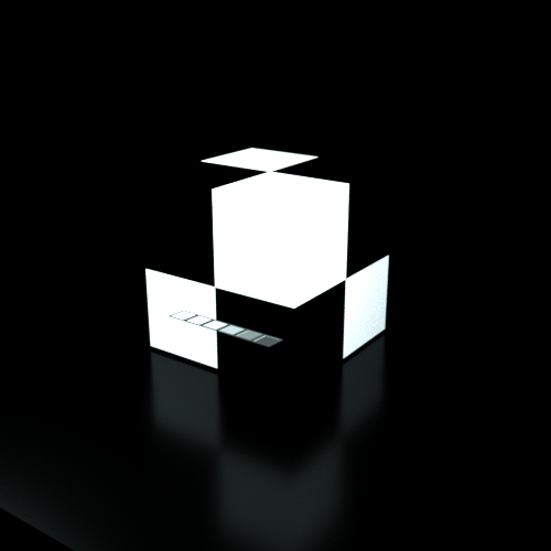

On this cube scene I applied a checker texture to the cube, at 100% scale on the texture the cube renders fine with the checker texture. From 100% to 55% there is not change in the size of the texture.

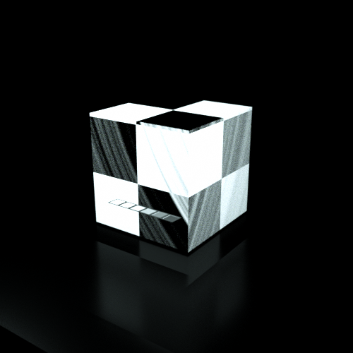

From 50% to 1% the texture changes its size but renders with artifacts if you change the scale in a large amount from say 50% to 25%.
if you scale to numbers other than 50% 25% 12.5% ,10% 6.25% 5% 2.5% then you are fine there is no artifacts, those number cause artifacts
I'm getting lots of Octane crashes aswell. After Octane crashes I can no longer render the scene even after a Modo restart.
Here are some samples
The Checks texture does not work correctly at the scene original. Move it off 0, 0, 0. See http://render.otoy.com/manuals/Revit/?page_id=165.
Move the cube a fraction off the center of the scene (ie. off 0, 0, 0). To adjust the checks scale, use the Scale sliders on the Transform pin of the Checks node.
