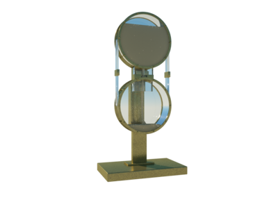

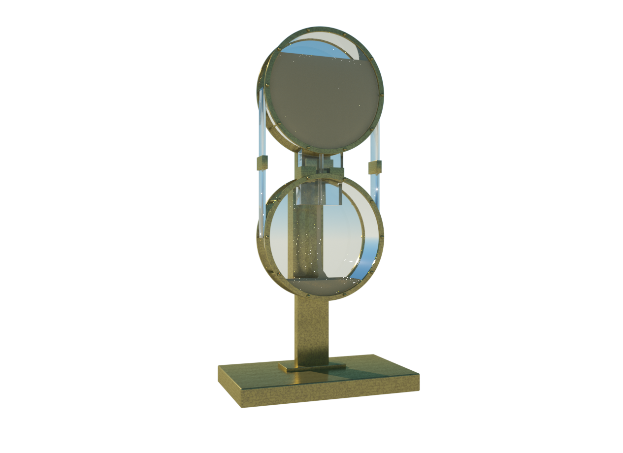

I have raised the level of hotpixel removal in my octane camera to 1, but i still have them pixels. Is there anything i can do to remove them? Thanks

hotpixel removal
Actually, when it comes to hotpixel removal,
1 = "no hotpixel removal",
0 = "maximum hotpixel removal"
It is a bit counter-intuitive, I know.
