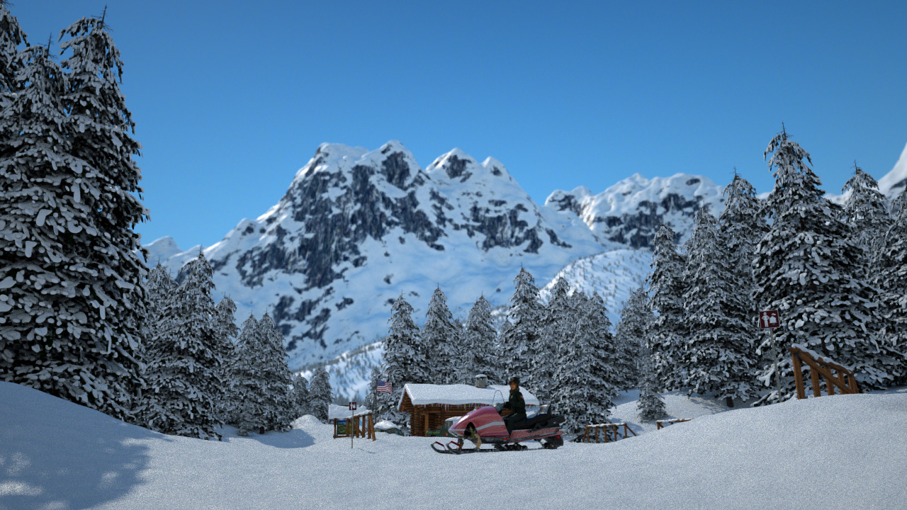

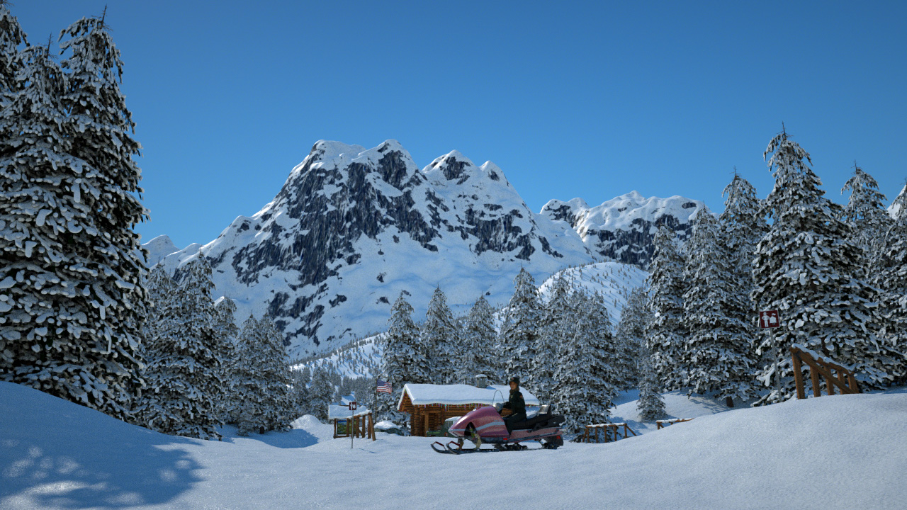

Hi, I tried with my winter landscape scene, to replace the mountains in background and the physical sky by an HDRi. I have put the gamma of the HDRi at 1 and increased the Power of the Environment to 5. It works fine, and the Sun of the HDRi sky casts strong shadows like the original physical one.

Cool. I read on one of the threads on this forum that HDRI lighting makes the rendering time speed up by a large factor. Did you notice any significant speedup?ROUBAL wrote:Hi, I tried with my winter landscape scene, to replace the mountains in background and the physical sky by an HDRi. I have put the gamma of the HDRi at 1 and increased the Power of the Environment to 8. It works fine, and the Sun of the HDRi sky casts strong shadows like the original physical one.
I have just updated the images, because I had uploaded wrong images without background !
I have done just a quick test, that's the reason why the brightness is a bit different on the two images. I have rendered few samples and not watched to the rendering time.
EDIT : Tested the speed : In this scene 3.39 Ms/sec with HDRi versus 3.15 Ms/sec with real geometry and physical sky/sun.
The obvious gain that I have noticed on this scene is about memory amount : I saved 1GB of geometry by rendering a panoramic view of the background mountains and using it a 4096x2048 HDRi environment !
My only little problem is that I have some difficulties to match perfectly the location/scale of the mountains between HDRi and the actual mountains to reproduce the scene at identical. Also, the diameter of the environment sphere has some importance if you move the camera at high altitude.
EDIT : I have updated the images in the previous post. Now the HDRi is first and its power is 5.

I think Physical Sky/Sun is always very fast. The problem is when you set up custom emitters. That is where I take a huge hit in render times.
In your HDRI background test, it is a tad blurry, but, unfortunately, Octane does not allow you to go over something like 8000 x 6000 pixels. Not sure why they put a limit on that. So if you increase your resolution to roughly double what you have, it should be a lot crisper, but still not super crisp. But then your texture memory usage goes way up.
