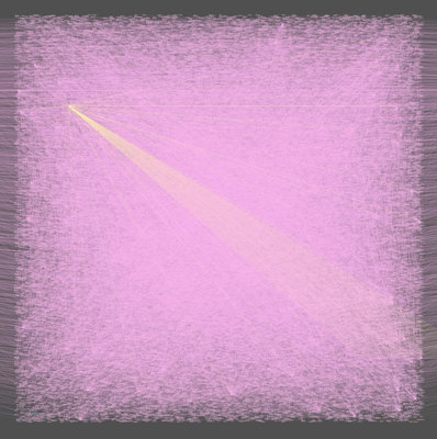

btw, there are more reasons an export with previous versions - even if using saved .obj files would have been possible - would most probably have ended up in tears; simply just because the standalone node display - meant to work with single or a low number of objects - had some limitations and wasn't capable to cope up with the enormous amount of nodes that a plugin may internally create. to give you an example how this could have looked like in the standalone: some extreme example, but still easily to get; can't remember the exact number - must be in the range of 30k nodes...
