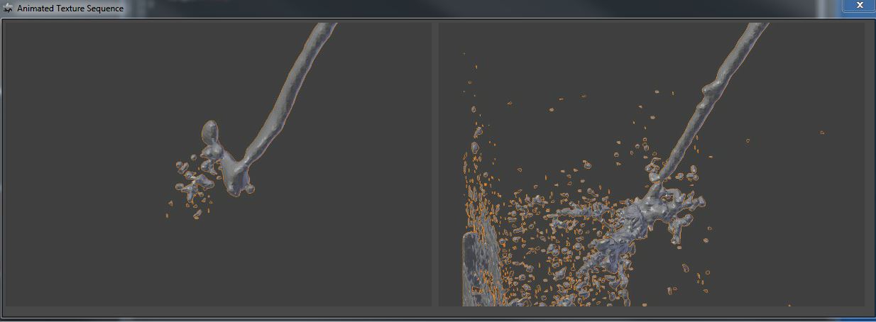

How can I control the size of the bitmap that's loaded. The image command seem to set the loaded bitmap to the image size, but if I wanted to set a thumbnail or 200x200 so the images would be side by side. Adding width=200 height=200 doesn't work, will have to use a different method to resize the image first.
In the sample below I used smaller images, but would like to control the size to be even smaller

Tugpsx wrote:How can I control the size of the bitmap that's loaded. The image command seem to set the loaded bitmap to the image size, but if I wanted to set a thumbnail or 200x200 so the images would be side by side. Adding width=200 height=200 doesn't work, will have to use a different method to resize the image first.
Code: Select all
-- picture bitmap
local picmap = octane.gui.create
    type    = octane.gui.componentType.BITMAP,
    image   = octane.image.load("/home/thomas/Pictures/script_menu.png"),
    opacity = 0.5,
It doesn't scale the image, the bitmap takes the dimensions of the image.
