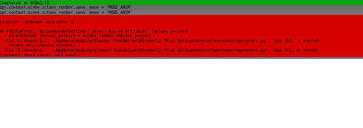

it is a bit of time I do not use octane for animation end today gave me the error visible on the attached.
What is this error?
all goes well for images
thanks

error "...\Blender\2.70\scripts..."
You should be using Blender 2.69 octane edition

thanks now works
