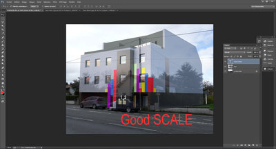

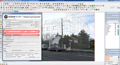

I do not know the trick to keep the same image scale for sketchup Photomatch. I hope it will be able to help some of you.

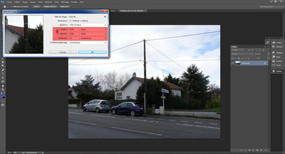

PHOTOGRAPHY insert in sketchup 2048x1536
PHOTOMATCH in sketchup

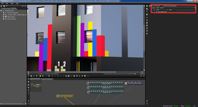

Render in OCTANE
DRAG AND DROP IN PHOTOSHOP (dynamic layer)
the advantage of the dynamic layer is that directory you can replace the contents by right clicking and thus retain all changes and masks.
Thanks.

The trick is to export Sketchup scene to .ocs with the exact same resolution that your photo has. When Octane plugin exports scene to .ocs it converts Sketchup FOV to Octane FOV (they are completely different). So when you have exported scene to Octane, DO NOT change the resolution of the image since it will break FOV match between SU and Octane.
Btw, this issue is handled automatically in upcoming OctaneRender Plugin for Sketchup.

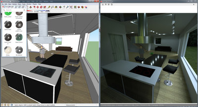

Am I dreaming or I see the Octane for Sketchup on your screenshot? :o :shock:
skibbbi
Posts: 68
Joined: Sat Nov 19, 2011 12:14 am
Location: Poland, Pruszków
smicha wrote: Am I dreaming or I see the Octane for Sketchup on your screenshot? :o :shock:
Yeah, explain it fuzzybro :twisted:
