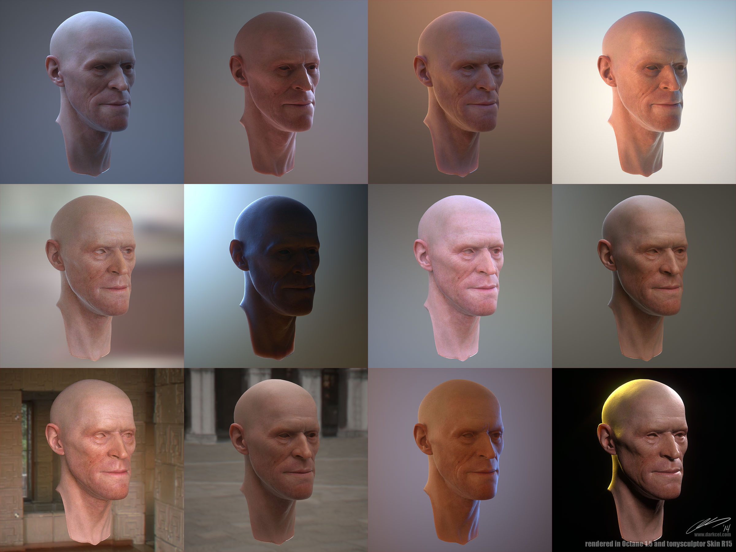

Hello all,
I just wanted to let everyone know that I updated my skin shader to work properly with the latest version of Octane. It is called "tonysculptor Skin R15", and can be found in LiveDB > Materials > Organic > Skin.
I simplified some of the inputs, exposed input pins for both levels of specularity, and tweaked some of the scattering settings. It should be easier to use and if your model is built to real world scale, it should work without tweaking any of the scatter scale parameters.
I ran the shader through its paces with several lighting tests. I tested numerous HDR environment maps, Blackbody Emission, and Daylight scenarios.
Check out the tests below, and enjoy.
tonysculptor Skin updated for Octane 1.5

As far as the skin darkness, I updated the default settings, which means that it should just work. Of course, it will always look darker at the beginning because of the nature of the material.
The tests are using mostly HDR environment maps (gamma set to 1, because they are already in linear space). The daylight power was also set to 1. The texture emmission lights are set to a power of 1000 to 3000.
I hope that helps.
