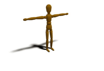

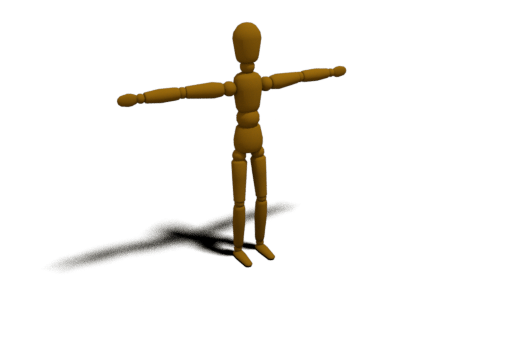

Does shadow catcher work in the plug in? That is to say, can I make a render that is the subject and shadow but no background?
I've tried to do this and can't seem to make it happen. I can get the shadows on other materials, but not on the matte material. The shadow just disappears in the render. Knew I must be doing something wrong.
The reason this is important is for compositing my shot in Nuke or AE or Fusion or whatever. My subject, which is 3D, produces a shadow that needs to be composited into my footage. The opacity and softness of the shadow are something better done in a compositing program then trying to get right in C4D. I'm trying to match the shadow that the rest of the footage has so it looks real. The lighting is the hardest thing to get right.

This is very helpful. I am able to export an object buffer and knock out the figure which gives me basically a shadow pass. It's not perfect, but I am figuring out a work around for all the various compositing problems.aoktar wrote:Hi,
