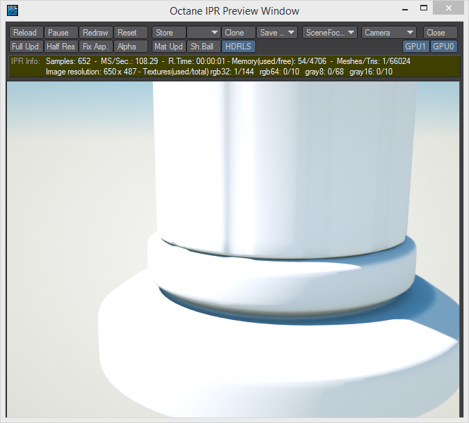

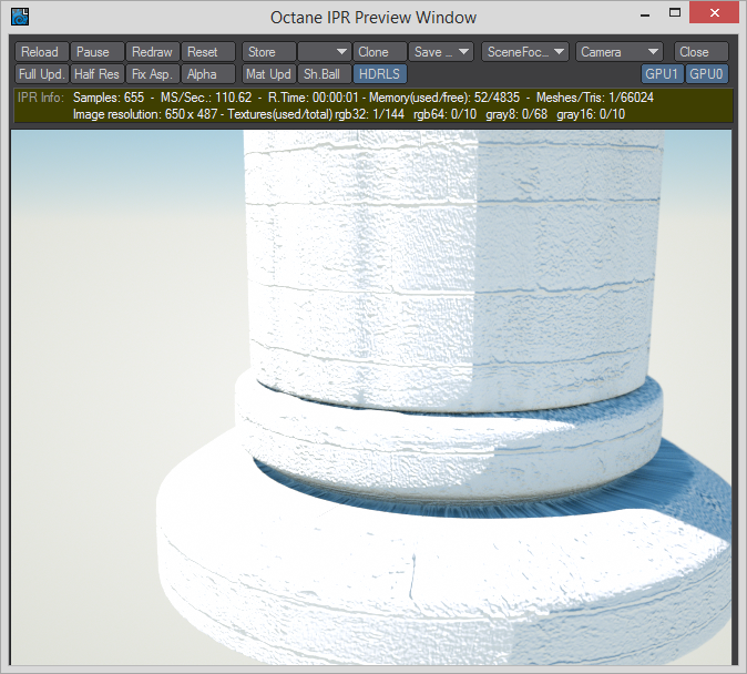

Firstly, that doesn't work. Secondly, the stupid sharp shadow issue makes even using a normal a waist of time.
No normal
Normal at strength 1
Normal at strengh 10
I don't mean to be negative, but is this another limitation of the software that is not going to be fixed until a version I have to pay extra for?

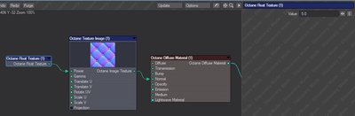

As workaround you can plug a float texture node into the texture power input. In this float texture node you can set values beyond 1.0 and with this setup it should work.
-Juanjo

Yup, that works.
However, as I said in previous post. Pointless as the hard shadow screws it all up. No point even trying to use it.
