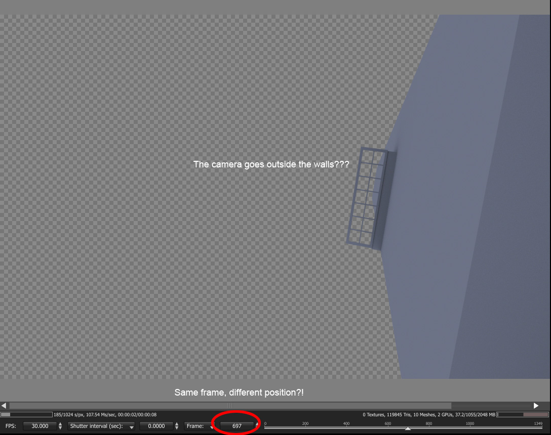

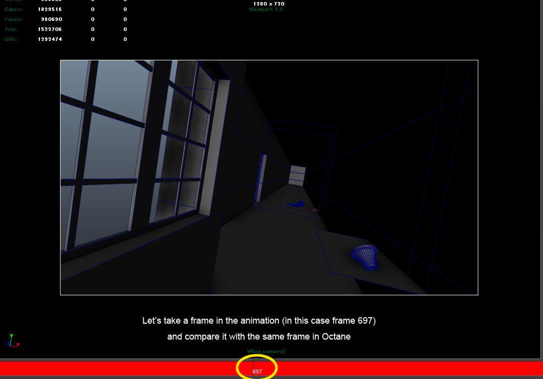

I still have no answers on my first post in this thread, I cannot manage to export a camera animation from Maya, and having it match the scene, is anybody else having the same issue? I don't know what to do! :(

Can you post the different images you are getting? The environment appearing smaller or larger depends on the field of view of your camera, a wide angle field of view results in the environment appearing smaller. And the field of view is not affected by the scale.
If you are importing both an OBJ and Alembic file, are you connecting the geometry and the camera output of the Alembic node to a render target node?
Roeland
Yes, they are both connected to the same render target, and it's not the FOV, that is correct, it's like the camera I export and the scene are slightly shifted, I'll show you an example:
this is what I have in Maya
And this is how appears in Octane

roeland
Posts: 1826
OK, we found the problem, it's a bug in the camera importer. I will make a test build later today, so you can test if it fixes your problem.

roeland
Posts: 1826
OK, the test build is up here:
64-bit Windows test build
Roeland

roeland wrote:OK, the test build is up here:
Roeland
It works! I love you!
