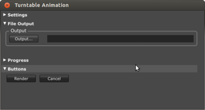

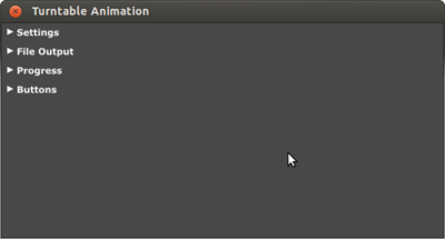

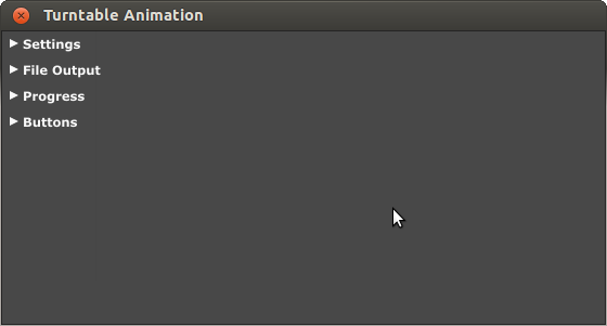

Here are some screenshots:
If there are questions, please ask.

I would like to avoid showing a bunch of empty space below the collapsed panel stack items.
I can't seem to figure it out. I'm guessing on the mouse event one should toggle the height of the main form, however if my panel stack is not the last item, that simply truncates those that are.
Coulds you please provide some sample code.
many thanks
Mark

Hi Mark,
We don't support resizing yet in lua. That means if everything is collapsed you'll have empty space and then when everything is expanded you need to scroll. Not much we can do about it right now.
