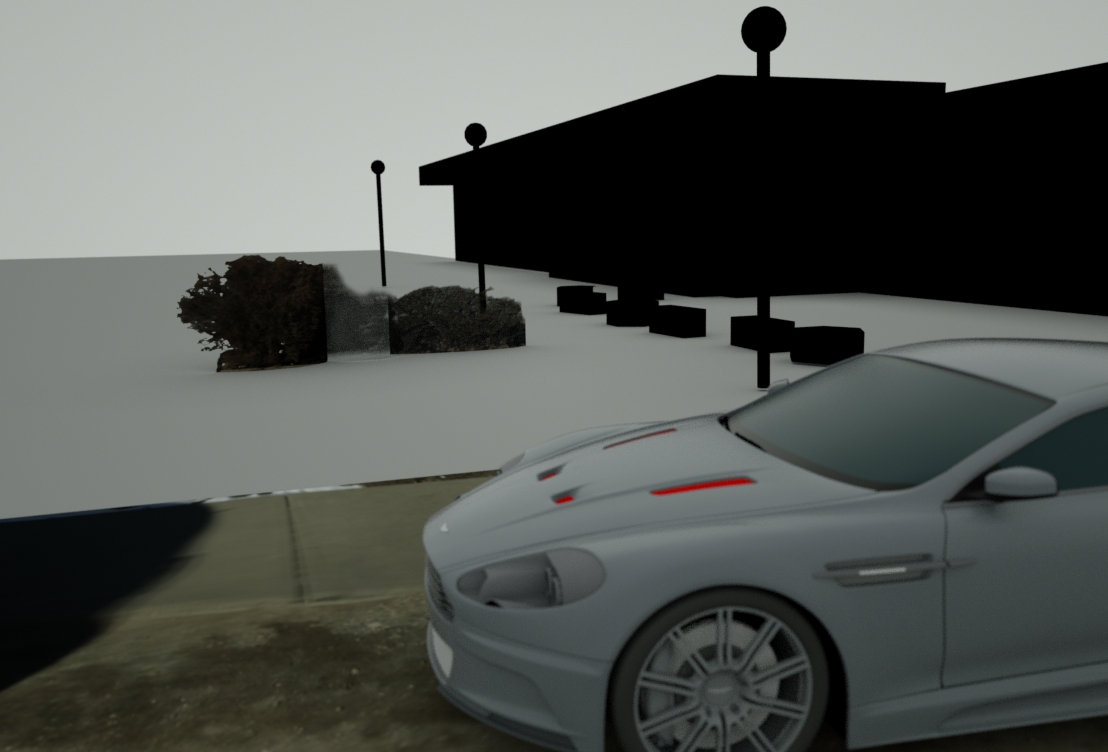

I am working on a camera tracking scene...lots of textures
I have some bushes with alpha cutouts...
When those materials are enabled....the surrounding textures go grey...
Everything is TIFF....I just used the same image for alpha and color....
the bushes are on 3 separate objects and the ground is on 2 (2 that you see gray anyway)

just tried cloning the textures in question....and changing there alpha settings...
instead of using the same texture for color and alpha....
same issue

is it possible this is just hitting a memory limit on my video cards?
these are large textures...
EDIT:
It appears this is a vid card memory limit....
its an old scene...some textures are 8k and a few are 4k :mrgreen:
before I had to worry about octane limits
Intel i7 980, 24gig DDR3, 2x GTX 470, 1x GTX 590

EDIT 2
seems this was more of a limit with rgb64 limit....
in the octane IPR it appears to only allow 4 rgb64 textures...while rgb32 is 64 textures
juanjgon
Posts: 8867
Location: Spain
Yes, the number of textures are limited by the CUDA architecture. In the GTX 6xx and 7xx you can only have 10 floating RGB textures plus other 10 floating gray textures. In older GPUs this numbers are even low.
-Juanjo
BorisGoreta
Posts: 1419
Joined: Fri Dec 07, 2012 6:45 pm
You can always combine several textures into one.
mdharrington
Posts: 249
Joined: Fri Dec 09, 2011 11:08 pm
I just converted them to 8 bit Tiffs for tex with transparency and jpeg without.....and problem solved....
actually a good testament to how many large textures you can load into a scene...
I have 1x8k texture, 1x6k, 2x4k, and probably 4-5 2k, and about 15 1k textures....
They all load no problem....just a little limited on the FP textures on my system
