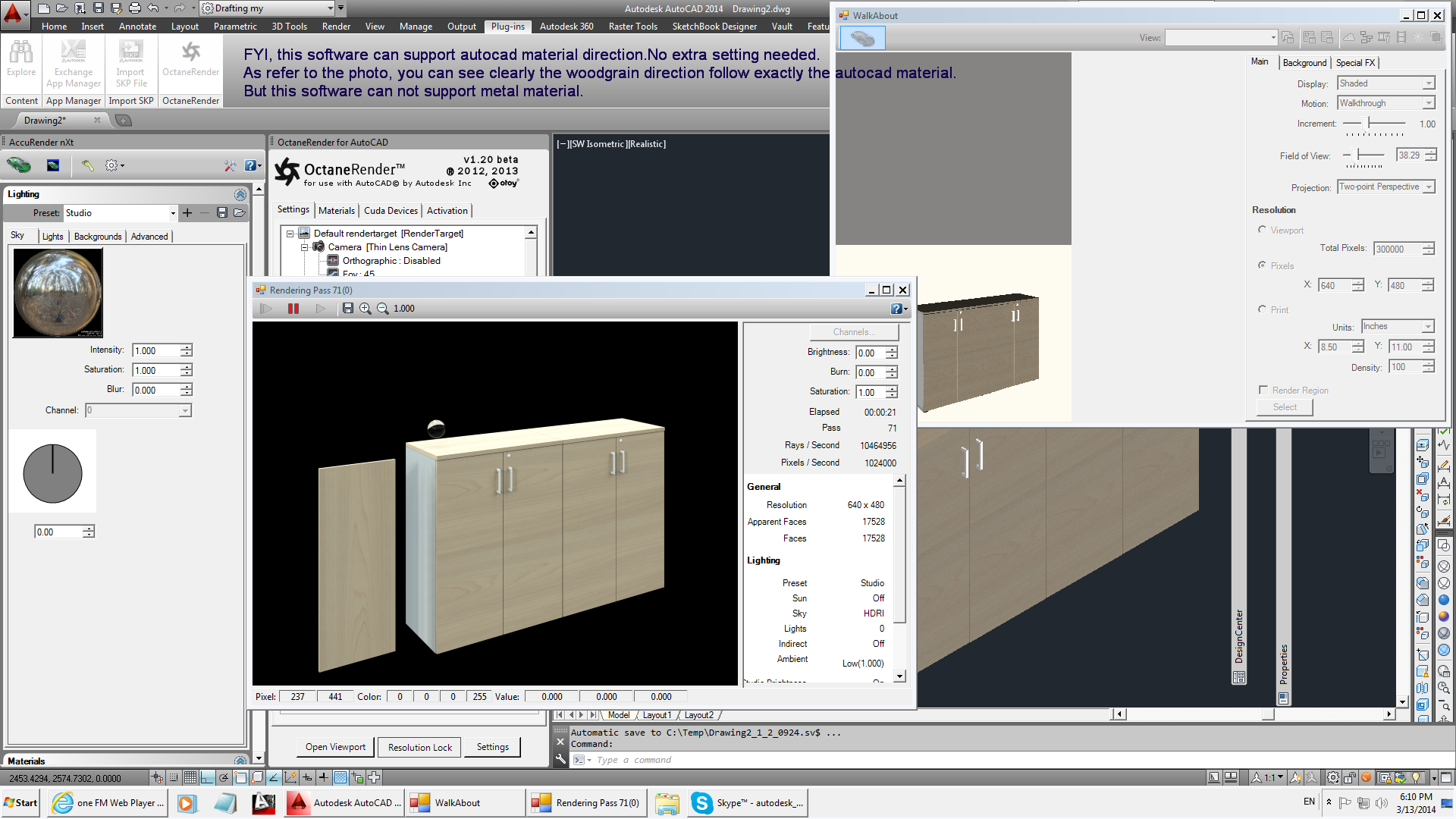

Hi All, I already try the trial version. I have some comment, kindly refer to the attachment file. Wish to see the improvement in next version. Thank you !! :D :D :D

1) To set a background color: Change the Environment in the "Environment Texture" to an RGB Color node, and set the color to white. Pls see the manual for details - http://render.otoy.com/manuals/AutoCAD/?page_id=466.
2) Wooden Grain material going in the wrong direction: Yes - this is because AutoCAD does not provide accurate UV coordinates to plugins. You simply need to rotate the material 90 degrees (via the Image Transform). I note you have setup Box projection on the screenshoot you have provided which will also work, but UV projection may be better in this case. Once you have converted an AutoCAD material to an Octane material and adjusted it "Save As Default", so the next time you use that AutoCAD material, the saved Octane material will be used - which will save you a lot of time. See the manual for details. http://render.otoy.com/manuals/AutoCAD/?page_id=35
3) AutoCAD glass material: I thought that most AutoCAD transparent materials would automatically convert to Octane Specular materials - however there may be some that don't. If you can give me the AutoCAD glass material name which is not correctly converted I will investigate.
4) Sky Lighting. With HDR lighting - the lighting comes from a HDR image - so you cannot change the background color (since the background color is coming from the image). If instead you select "Daylight" lighting, you can adjust the sunset and sky colors. Only perspective camera mode is supported by the plugin at this stage.
5) AutoCAD metal material conversion: AutoCAD does not provide an indication to a plugin that a material is "metal", so you will need to make some small modifications to the converted Octane material. Generally this will involve increasing the "index". You can also download many metal materials from the Octane LiveDb which provide incredibly realistic metal renders. Once you have an AutoCAD metal material the way you want it, "Save as Default" so that that Octane setup is next used when you use that AutoCAD material.
Hope that addresses your concerns.

Maybe i'm using demo version, so I cant see your own material.
Yes, the demo version of the plugin does not give you access to the Octane LiveDb materials. The full version does.
Regarding HDR lighting, example Render keyshot environment can change the background to any color when I use HDR lighting.
You can do some color adjustments of the HDR by plugging the HDR image node into an Octane multiply or Color Correction node, and then plugging that node into the Texture Environment. (See image below).
I will try again for woodgrain issue. Can you provide more render tutorial video to learn.
Pls see images below. In summary, change the Image Transform to 3D Transformation (to expose the rotation pin), and then rotate the texture by the Z slider.
Your default rendering engine already can run high resolution image is it? or need to adjust it by ourself? If yes, how to adjust it?
The version you are running is limited to a render resolution of 8000x8000, but the latest version is much higher than that (you will need a lot of VRAM to render very large images).
Paul
