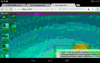

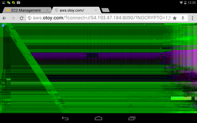

i have my ami setup but i can't stream smoothly from a tablet, nexus 7 (2013 edition).
It is not the network because using my haswell pc w/o discrete graphic, the fps went up to 11-20, decoding takes the most time at ~70ms.
What is your tips on getting low/mid end pc or tablet get 60fps such as the ipad in this video?

As mentioned in the docs, this is coming later this year. The issue is that WebGL is not very well supported on low end GPUs at the moment on Android (and not at all on iOS). That is improving, and as it does, you will see almost native performance on mobile browsers this year.
IOs Safari, as it has no WebGL, doesn't use the same compression as android, (it is I-FRAMES only). It is faster, and quite low latency, but higher bandwidth. Also, we have a native iOS app library, that we may expose down the line if necessary - it is currently used in Autodesk Remote.
