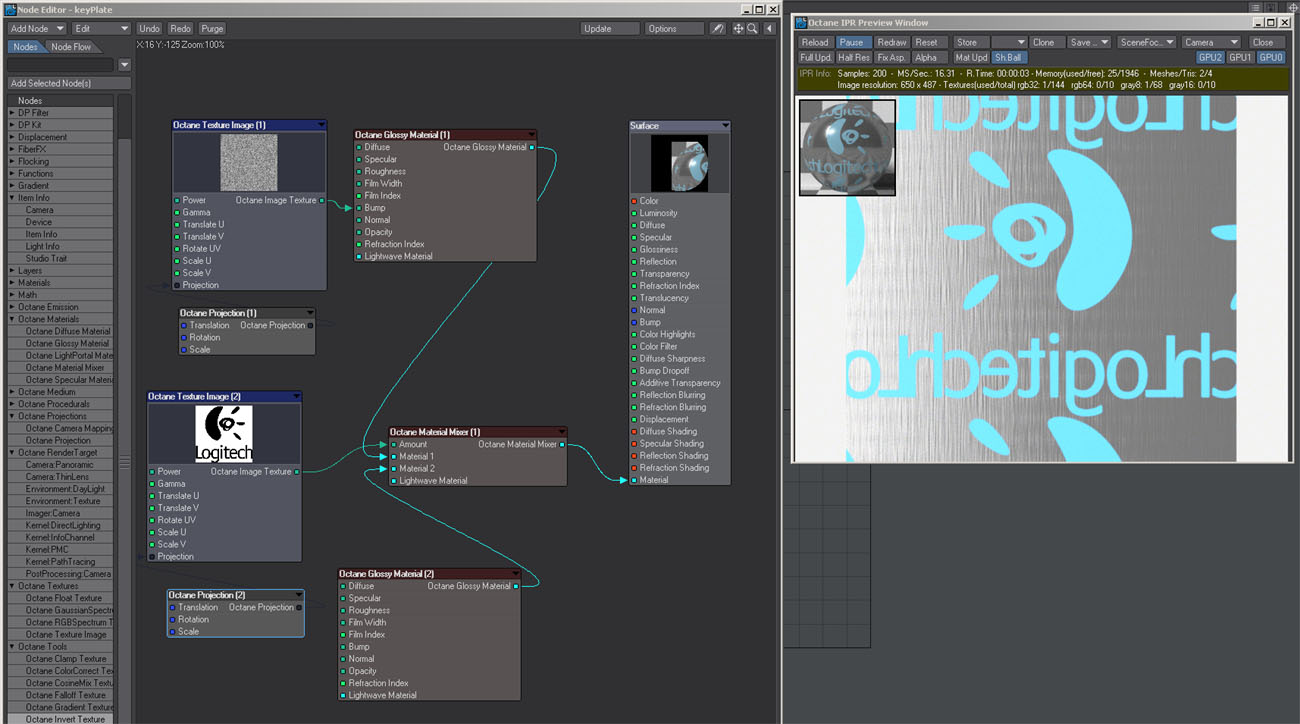

Ok, here are some pics. Firstly, another issue I've stumbled upon.
Image is controlling the mix. Notice how the logo is inverted.
Now I have plugged the 2nd material directly into the surface node and have plugged the mix image into the diffuse. Now the image is the correct way around. This strikes me as pretty odd.
Now the issue I mentioned yesterday.
Brushed surface and logo are mixed via image.
Now the brushed surface is plugged directly into the surface node. Notice the brush scale and/or strength has changed.
I don't know if I am missing something obvious but this does not seem right to me.
Scene file attached.
Cheers!
projectionIssue.rar
(1.89 MiB) Downloaded 223 times

I am testing this issue in Standalone and it also happens there, so I think that this is a Octane problem. I am going to post this bug to the developers team to see what could be the problem.

Hmm, had a look and I'm not sure I understand what is going on either. I'm fairly sure it's because you have different projection nodes. If you use the OctaneUVMap node into the normal input instead of the new projection nodes. Then alter the texture U and V settings to what you want, this problem isn't there. So it's definitely something to do with those projection nodes. Quick fix, either UV it, or use the UVMap tool.

I normally use the UVMAP node using the LW T function (single click, autosize, cannot go wrong!)
but the downfall with this is if you use images with differing scales. That is why I tried the new projection tools. I could use a UV map; sometimes that is not suitable though.
Juanjo, is the image flipping an Octane issue as well?
Thanks for looking into this.
Andrew.
