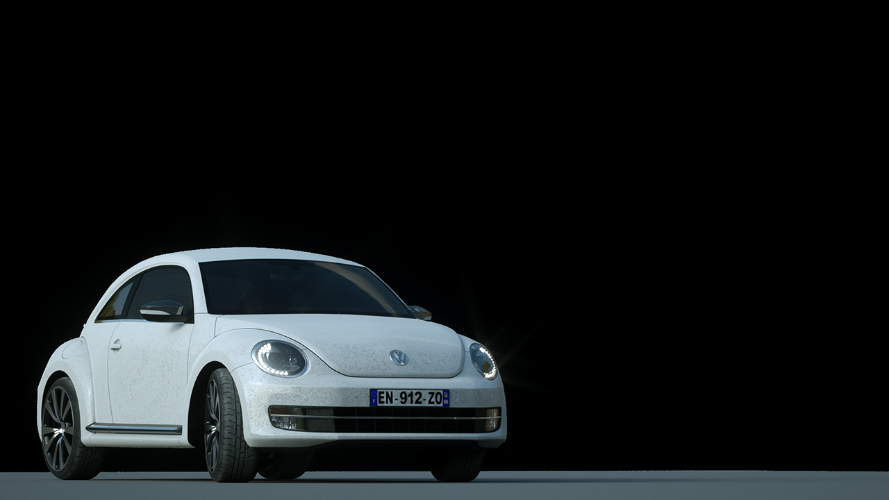

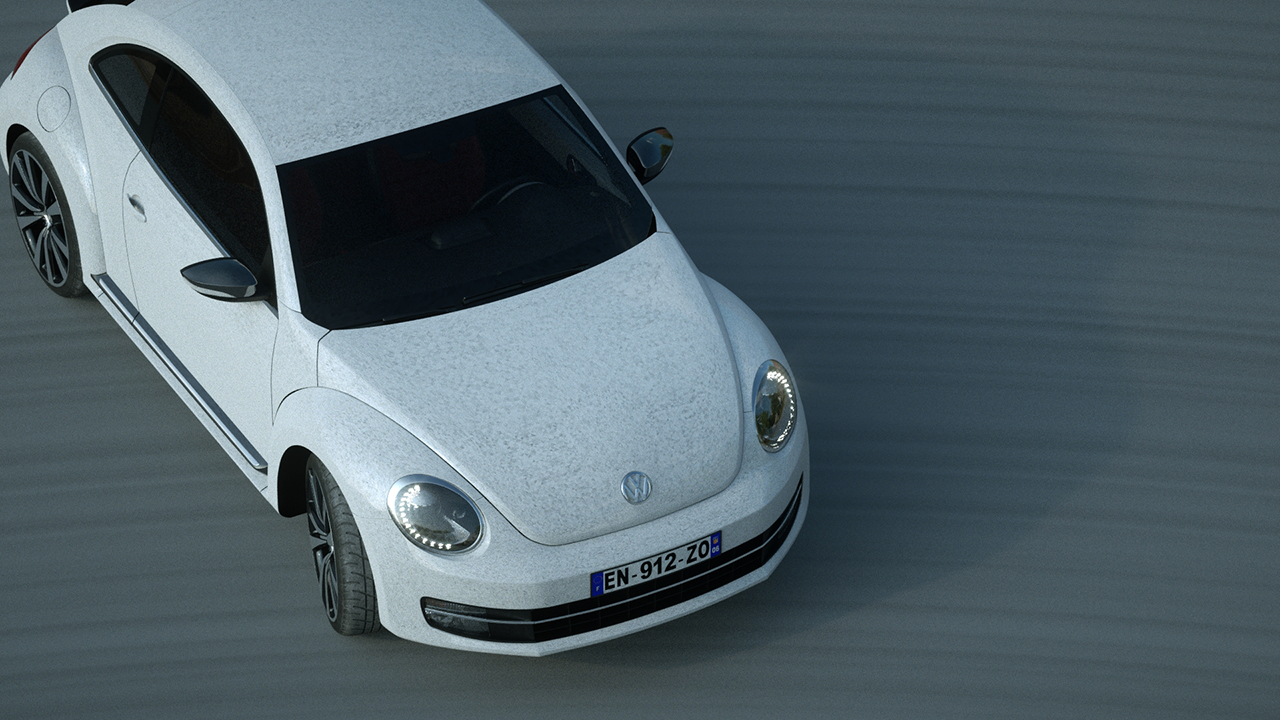

I have a rendering problem I can not solve.
I'm doing a render with a vehicle, lot of black spots appear on the body.
a picture will be clearer than words :
If i move the camera, black spots disappear :
Another exemple:

try to increase the rayepsilon value, I'm quite sure that that is the problem (in one of your picture I see some concentric circles that are tipically generated by incorrect rayepsilon value).

Thanx paoloverona,
The value was 0,0. I set the value to 0.001 and it works !

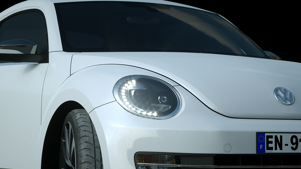

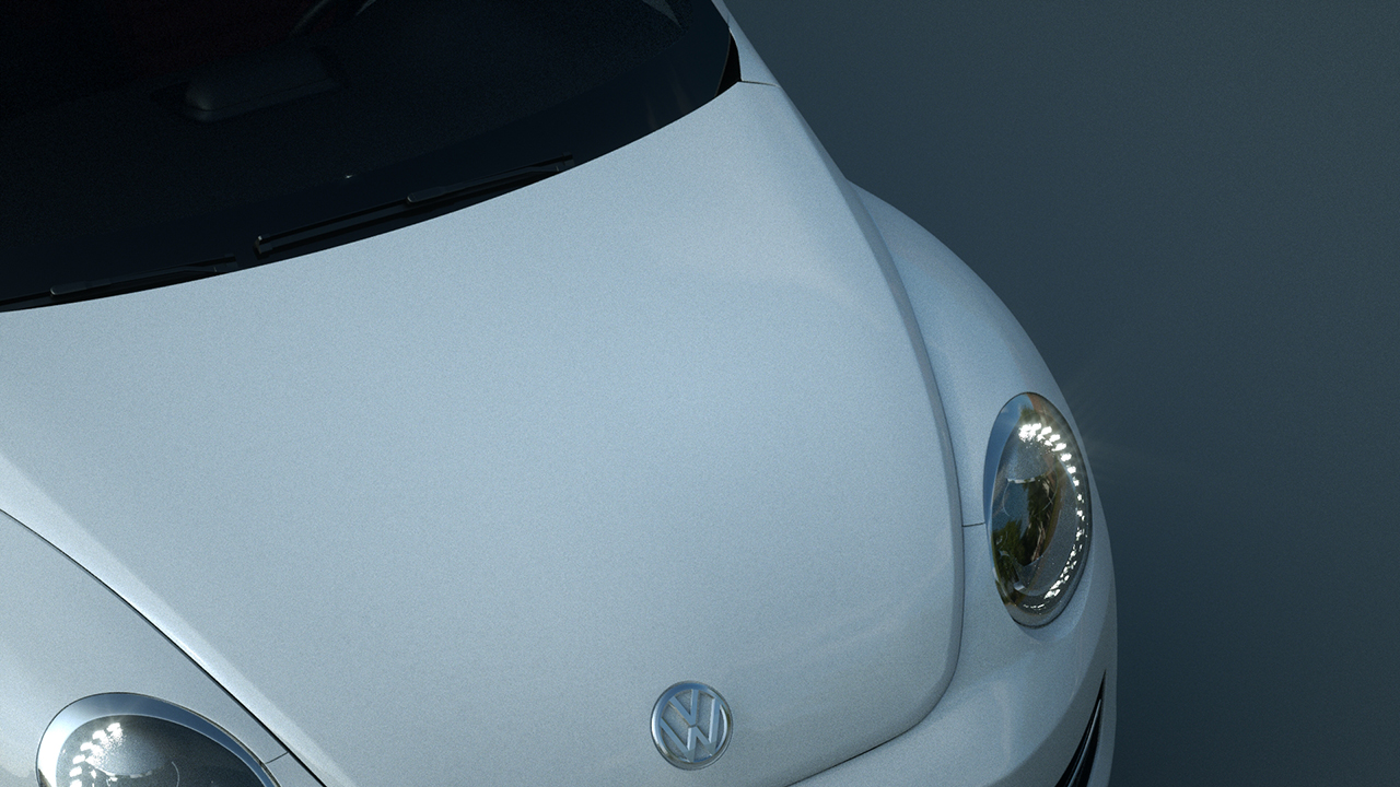

1.18 :
1.31 :

1.18 :
1.31 :
Hi enzo
difference come from environnement map that don't have the rotation (check the translate 2d map)
