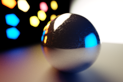

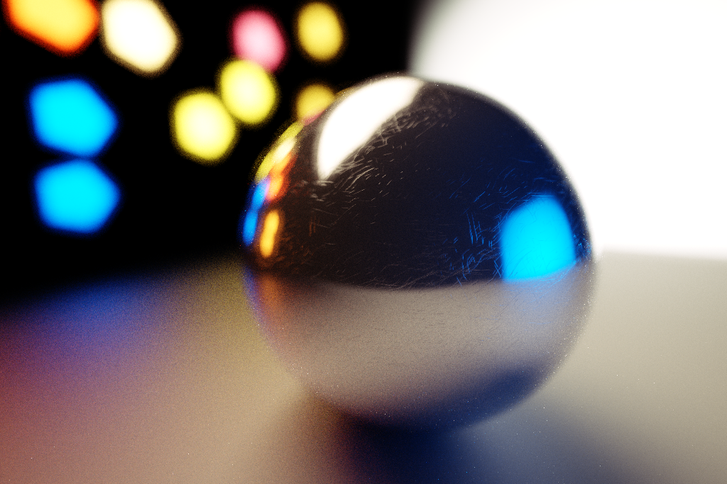

this is normal rendering with DOF
and this is accidental glow effect inside Octane with DOF

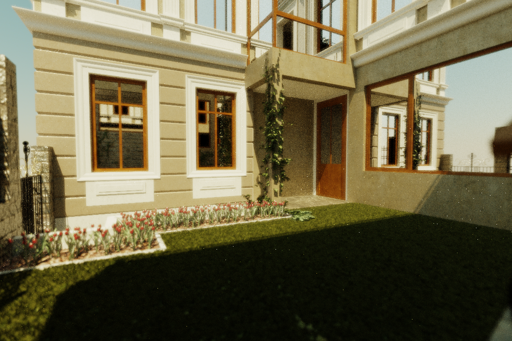

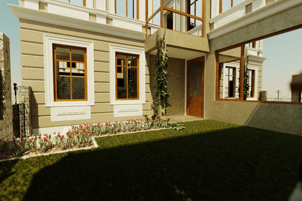

I test that in working scene :
render normally:
rendered with DOF glow:
no render times increased at all..
DOF accidental glow effect

Just disable AF mode, pick object, focus it with focus picker and center it with zoom picker, now zoom out to see the object witch will be fully unfocused, wait to clear (enough samples) and click on AF mode, you'll see the focused image overlaying the unfocused and there is nice glow forming from unfocused image on the highlights..tomas_p wrote:Hi andrian

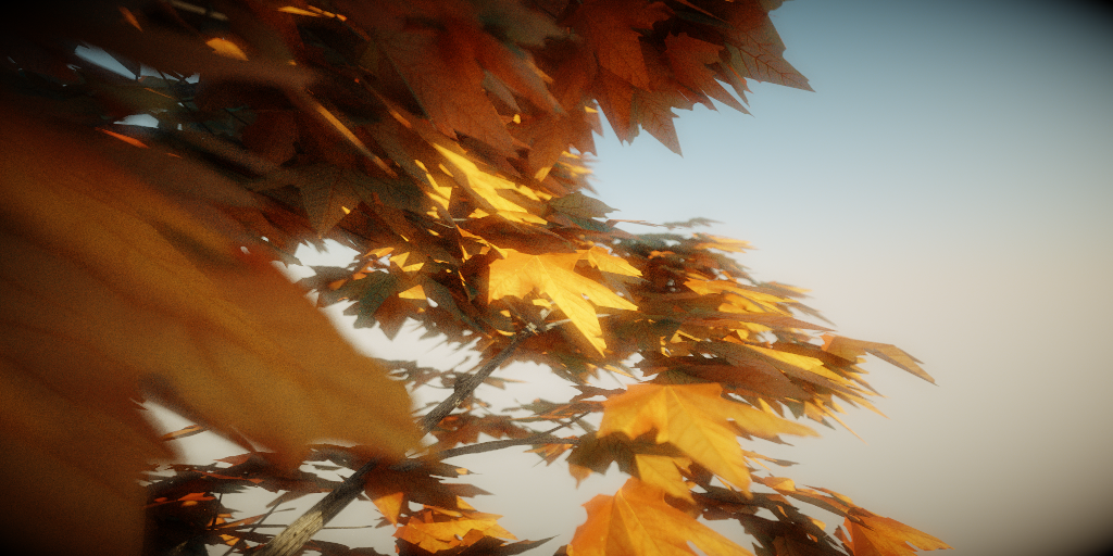

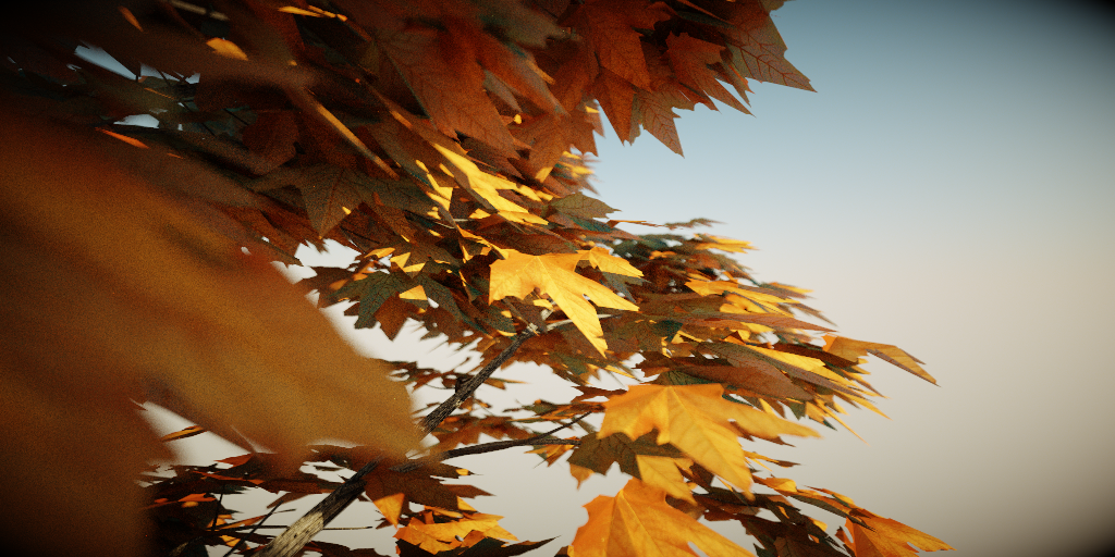

new example :

You managed to get bloom effect in octane

yep that's an impressive trick, should definitely be in the manual !
