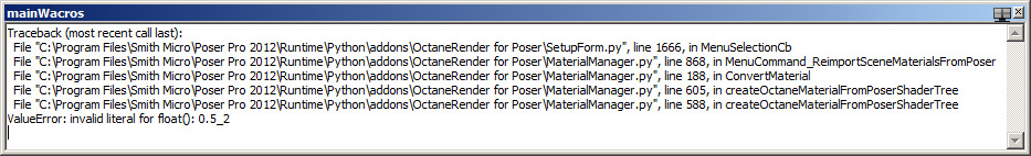

If i try to re-import scene i have a error

This is the error message ..
face_off
Posts: 15697
Location: Adelaide, Australia
Hi Andygraph3D - that error looks like it came from an old version of the plugin - which release are you using pls? Have you tried to save to a Poser material, and reload with the latest version?

yes i have make the update but now i have this error message when i try to reconvert to material from poser
Traceback (most recent call last):
File "C:\Program Files\Smith Micro\Poser Pro 2012\Runtime\Python\addons\OctaneRender for Poser\SetupForm.py", line 1694, in MenuSelectionCb
File "C:\Program Files\Smith Micro\Poser Pro 2012\Runtime\Python\addons\OctaneRender for Poser\MaterialManager.py", line 909, in MenuCommand_ReimportSceneMaterialsFromPoser
File "C:\Program Files\Smith Micro\Poser Pro 2012\Runtime\Python\addons\OctaneRender for Poser\MaterialManager.py", line 183, in ConvertMaterial
File "C:\Program Files\Smith Micro\Poser Pro 2012\Runtime\Python\addons\OctaneRender for Poser\MaterialManager.py", line 642, in createOctaneMaterialFromPoserShaderTree
File "C:\Program Files\Smith Micro\Poser Pro 2012\Runtime\Python\addons\OctaneRender for Poser\MaterialManager.py", line 625, in createOctaneMaterialFromPoserShaderTree
ValueError: invalid literal for float(): 0.5_2
--- and if i try the second time i see this error message:
File "C:\Program Files\Smith Micro\Poser Pro 2012\Runtime\Python\addons\OctaneRender for Poser\MaterialManager.py", line 900, in MenuCommand_ReimportSceneMaterialsFromPoser
File "C:\Program Files\Smith Micro\Poser Pro 2012\Runtime\Python\addons\OctaneRender for Poser\Node.py", line 1574, in MemoriseTreeState
File "C:\Program Files\Smith Micro\Poser Pro 2012\Runtime\Python\addons\OctaneRender for Poser\Node.py", line 1566, in MemoriseTreeState
File "C:\Program Files\Smith Micro\Poser Pro 2012\Runtime\Python\addons\OctaneRender for Poser\UiManager.py", line 2238, in displayError
ValueError: Error: null tree view in MemoriseTreeState for pin diffuse
