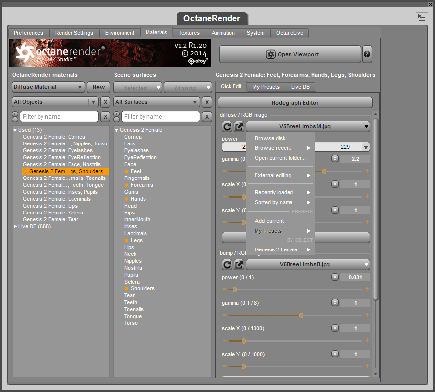

More duplication fun
Basic "Genesis 2 Female" objects appear multiple times when using Quick Edit to select an image map by object.
Win 8.1 Pro 64bit | GTX 660Ti, GTX TITAN, 6GB GDDR5 | Intel Core i7 3970x, 3.5 GHz | ASUS P9X79WS | 64GB RAM
						one time for each mapvortex3d wrote:More duplication fun

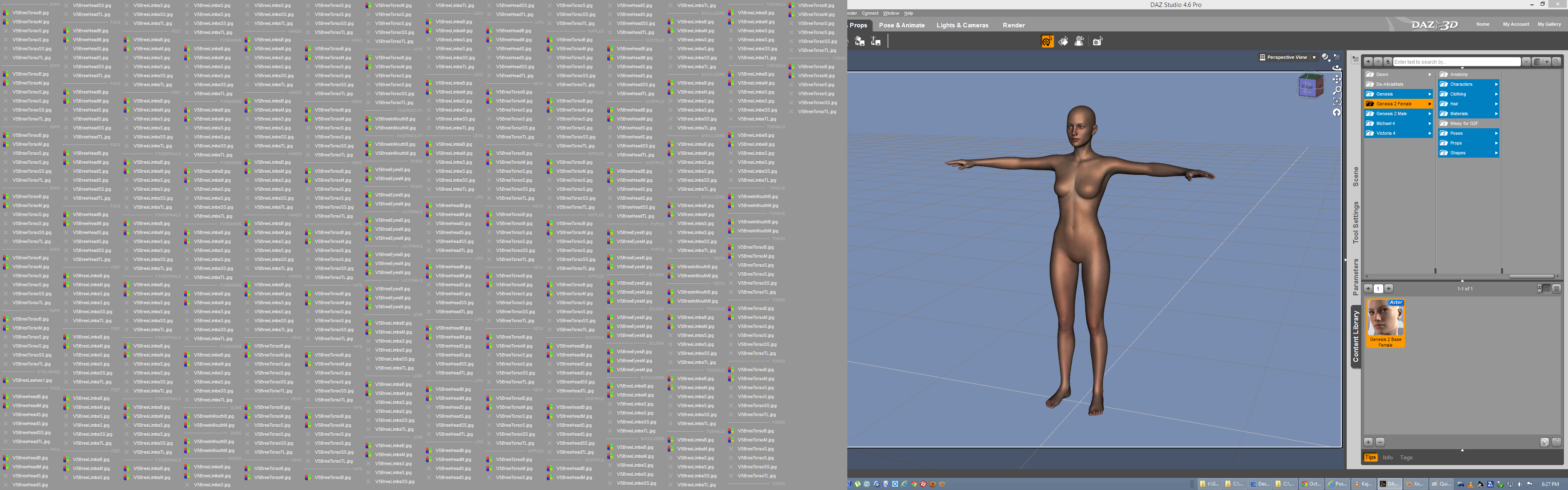

Attack of the clones!
Shared materials split randomly on load and saving at this point will make matters worse.
I don't know what triggers this behavior, but I can't duplicate it with single items or basic scenes.
FYI: This test scene was stripped of previous Octane data using the plugin's function. Could that add to the problem?
