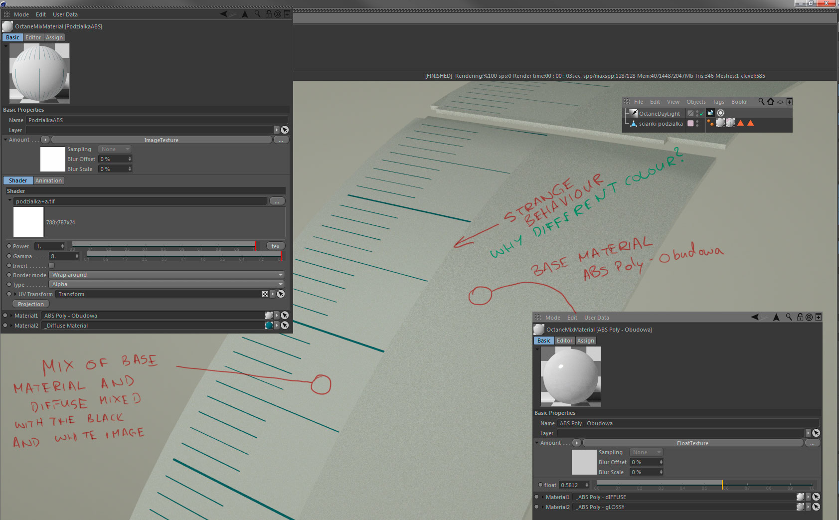

One object with two polygon selections, one part of the object is covered with Base Material and other is covered with Mix Material but the Mix Material is mix of the same Base Material and some other. Mixing is done by the black and white image.
After all there are different colours of the Base Material.
Why is that? and how to avoid that problem?
Am I doing something wrong? or just the strange bhaviour of the MixMaterial?
!!! Situation happens when I mix two identical materials as well !!!

a bug on mix material, i'll fix it
