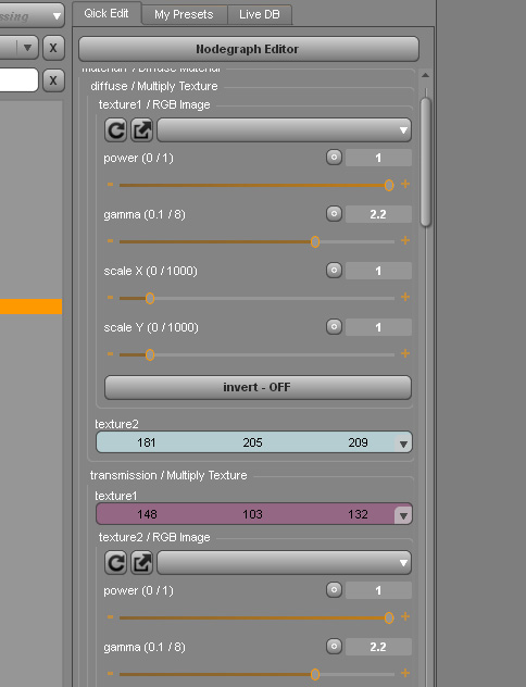

Probably it's the same problem I already reported, but nothing is shown where the name of the image should be.
Here a screenshot :)
The textures are loaded anyway.
Note : I applied a material from the DS library ... Also I get a lot of crashes and probably because this.
Note 2 : No textures shown when I open a scene file.
Note 3 : after some testing I think the problem is related to the other one I reported previously.

AlfaseeD wrote:Probably it's the same problem I already reported, but nothing is shown where the name of the image should be.
Yes thats the one im getting, happens to me after I save a .DUF then later re-load it.
