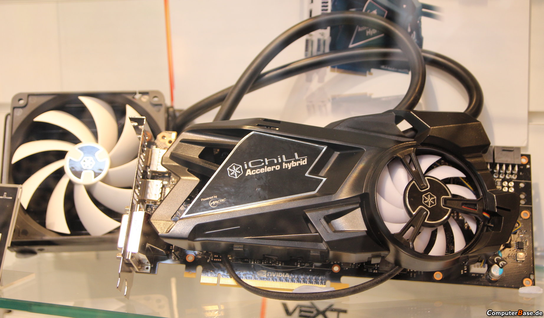

In reply to the connectors problem. There are a number of water cooling kits or water cooled Titan versions that may offer better clearance for connectors than the reference shroud design. Attach is a pic of one I found. May be go that direction? You would have to hunt out the most useful and do a bit of measuring and checking up to see if it would fit though. HTH
