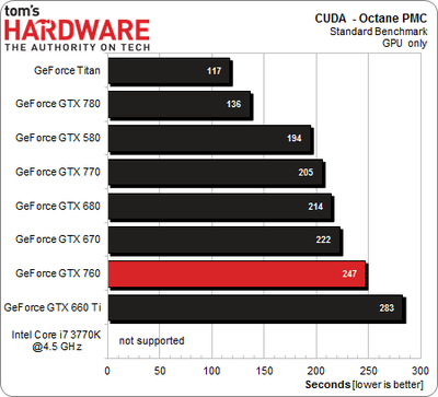

Hi, here you can see speed.

So it seems like basically when you factor in the memory expansion it about 2X the speed of a 760.

And it should be noted, for those who are still a little in the dark about CUDA cores and GPU rendering, that there are discrepancies between gaming performance and Octane (or other GPU engines) rendering.
For instance, a 760 may possibly give 20 more FPS in a game like Crysis2 than a 580... but as you can see in the chart, a 580 will smoke a 760 in Octane. Kepler cores are (apparently) more geared toward better gaming with less heat and fan noise, at the expense of 1/3 the raw rendering power of Fermi cores. Which is why 3 Kepler cores = 1 Fermi core.
