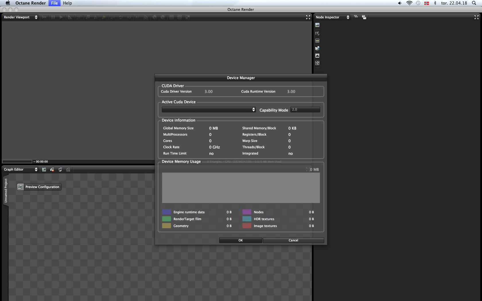

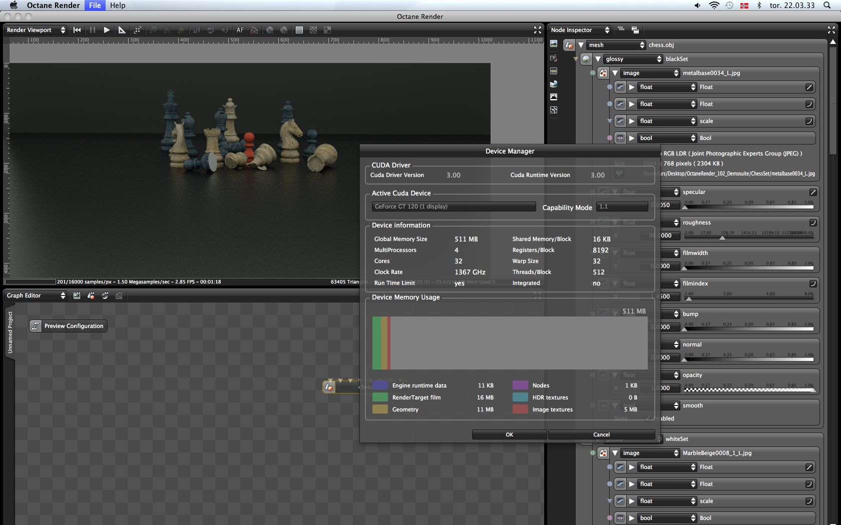

screendump 6 shows the default device manager. The active Cuda Device shows nothing. I changed that to one of the two available graphic cards on the computer (screendump 7). And it works!
Thanks for the support. I will play around and get back to you.

This appears to be a bug in the cuda 3.0 toolkit / drivers for mac.
we're working on fixing this for beta 2.2, it has been reported by another mac user on a mac pro with 2 GPUs.

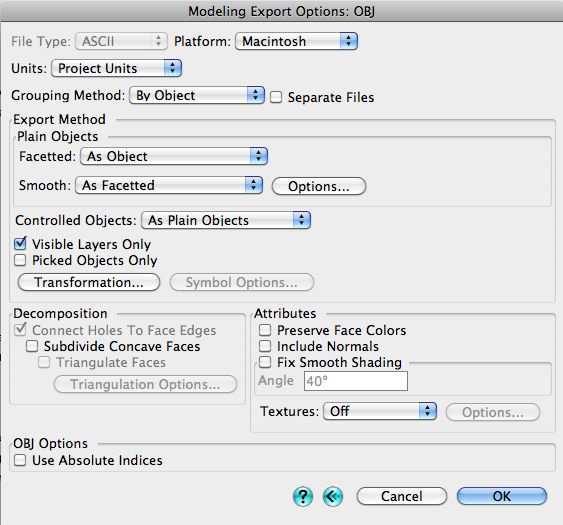

The fun did not last for long. It works fine with the demo files, but it still crash during loading when I try my own files exported from formZ. I have tried a few export options but not all combinations. I have enclosed one of my exported files.

radiance
Posts: 7633
platform = windows (not mac)
group by = materials ? if available
units = meters
enable include normals, enable fix smooth shading
enable textures
for facetted/objects i don't know, you'll have to experiment a bit.

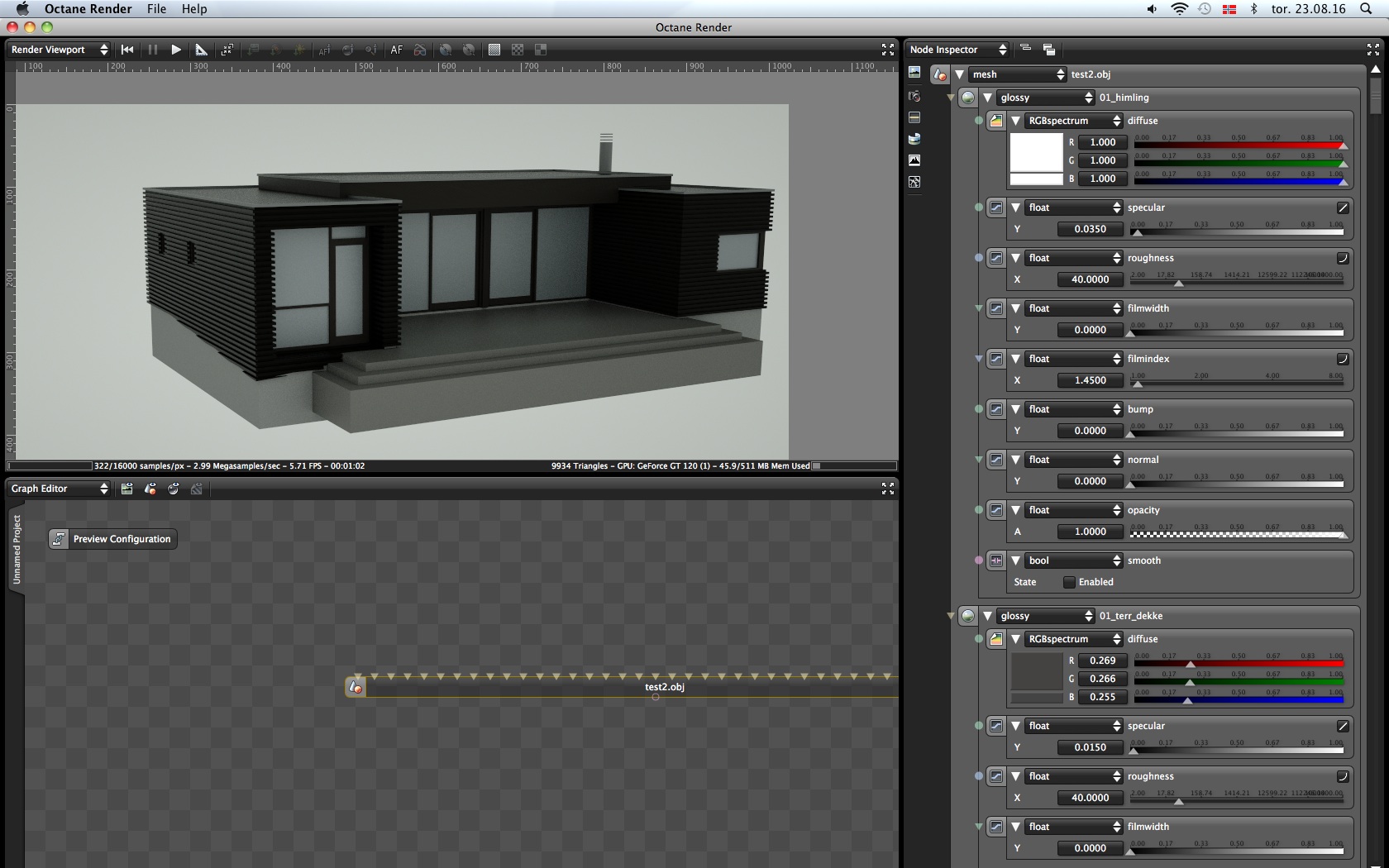

Robin
Posts: 9
Joined: Thu May 20, 2010 12:24 pm
It works at last!
