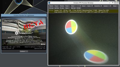

This scene no longer appears to show the light shaft.

UnCommonGrafx wrote:This scene no longer appears to show the light shaft.
Here it works fine with the 1.25 release ...

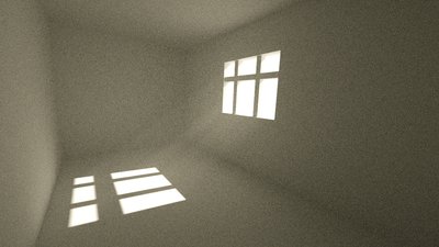

OK, looking for a little help with this.
The tutorials I've seen talk about having a fog object that surrounds the area, and a bubble to put the camera in.
The sample in this thread only has the bubble.
Can someone clarify this for me?
Also, is there a way to get the shafts visible, withouth the room being so blurred? If I turn down the effect enough to stop the room being blurred, the shafts aren't visible.
