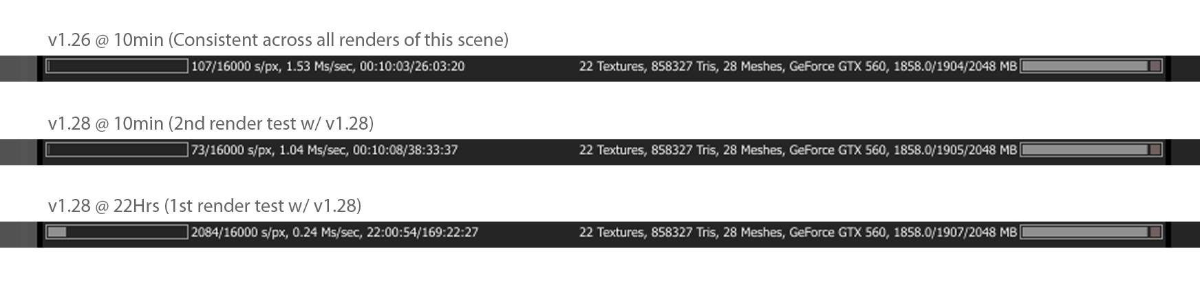

Seems like it has to do with heavy texture usage. When I'm pushing the limit of memory is when the problem seems to come up. If I dump a lot of the meshes and textures in my scene, the problem goes completely away and the times between 1.26 and 1.28 are identical.
See attached image of 1.26 vs. 1.28 times.

Ok, I have an idea, which change have caused this issue, but I need a scene to reproduce the problem and verify a potential fix. Do you think you can create/derive a scene that shows the speed drop?treddie wrote:Seems like it has to do with heavy texture usage. When I'm pushing the limit of memory is when the problem seems to come up. If I dump a lot of the meshes and textures in my scene, the problem goes completely away and the times between 1.26 and 1.28 are identical.

Ok, we had a look at the scene and we can't reproduce the slow-down here. Neither on Kepler nor on Fermi GPUs. Do you've got a second GPU and if yes, is SLI enabled in the NVIDIA driver settings? Which driver version are you using?

OK, I went into the control panel after doing some Googling, and did discover that in place of "Set SLI Configuration", I have "Set PhysX Configuration", which I assume is an updated version? Anyway, I went in there and I only have a field called "Select PhysX processor" which I kept at "Auto-select". I then backed out of the PhysX area and opened up "Manage 3D settings". In there, I went to the octane app and forced "CUDA - GPUs" to only the 560 (It was set to "Use Global" which automatically had selected both GPUs). This SEEMED to have cleared up the problem. But then I thought I would set everything back to the way it was and in doing so, I could not recreate the problem. My feeling now is that I had not rebooted my system in days and that somewhere along the line something got messed up. When I rebooted yesterday, I think memory got cleared and the problem went away.
