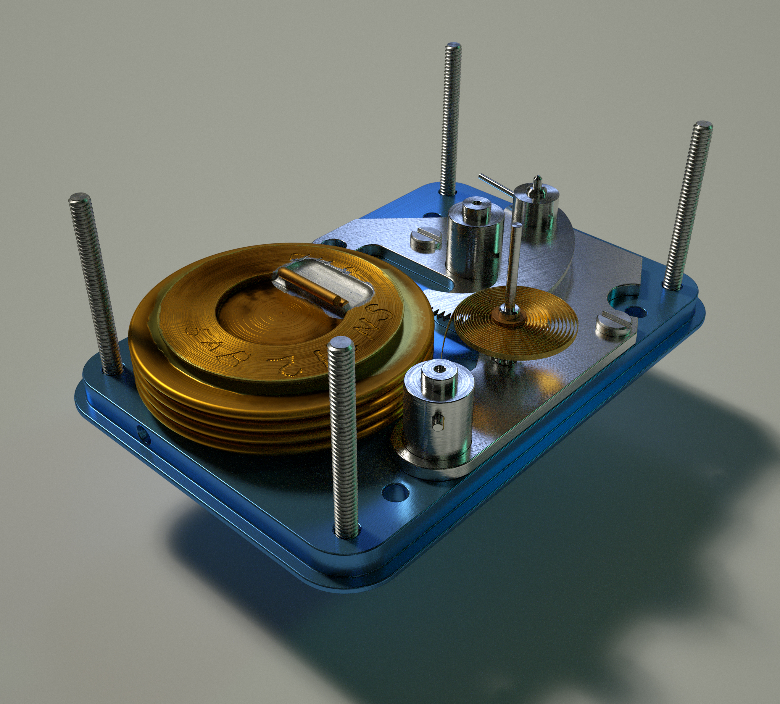

Latest update. That brass bellows on the left had a lot of texturing, so it took a while. Now that that is done, the rest of this thing will go pretty fast, I think. Everything else is pretty much basic.

It looks amazing.

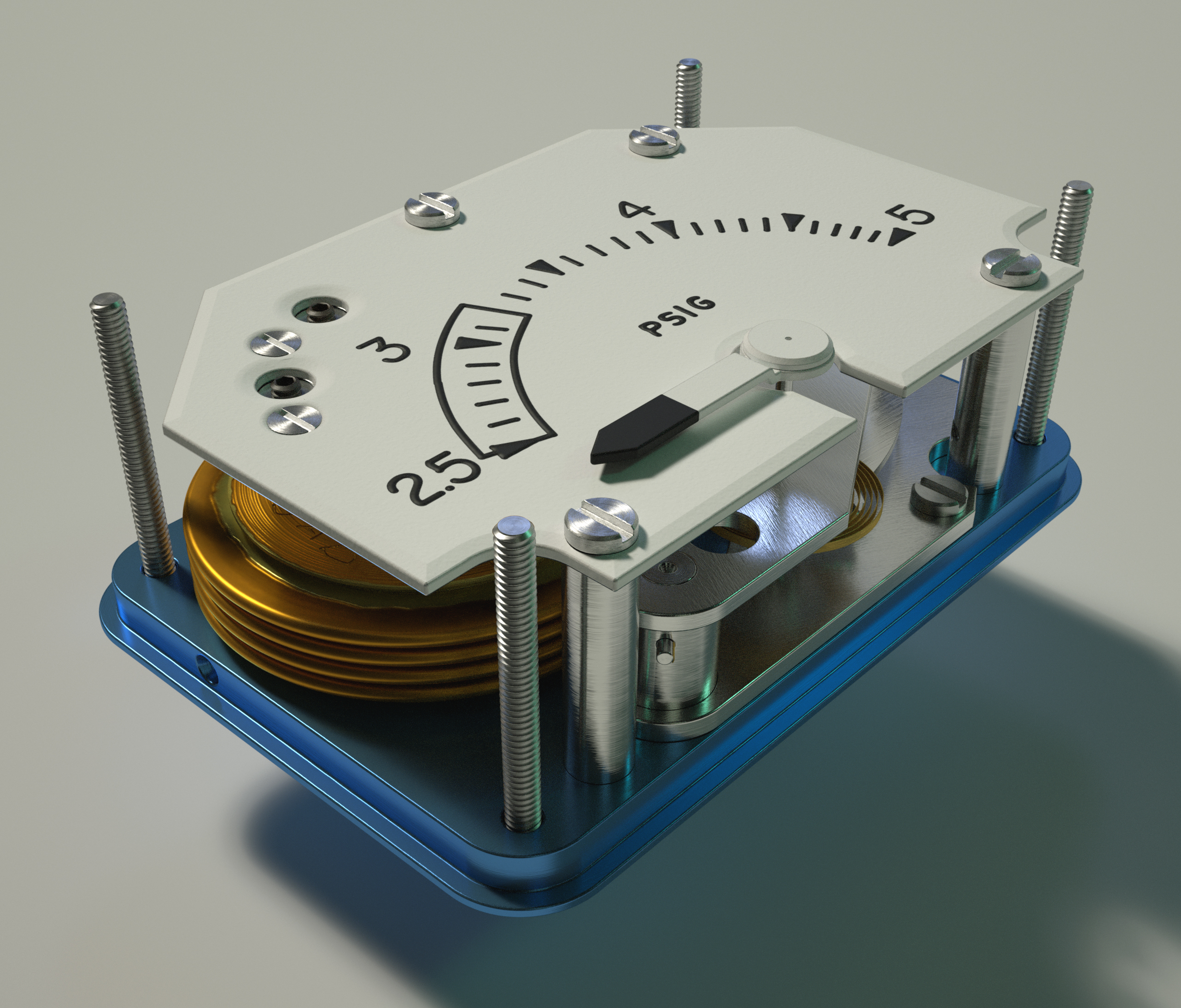

Two new images. Almost done!
The insanely badly done engraved serial number is actually true to form. After years of working with space hardware, I have always been amazed at the impeccable quality of workmanship, even for Class III hardware (not meant for flight). So when I opened up this gauge I couldn't believe how bad the serial number was, and had to laugh. At first I thought maybe it had been done by an amateur. Then I thought maybe it had been done by a guy on crack. I finally decided it had to have been done by an amateur on crack!
The hand-painted markings on the dial are also accurate. They were probably made with an old style ruling pen. So that jog in the arced box was actually there. I almost hated to do it that way, but I am documenting history, so there is no leeway in that respect.

Awesome work man.
