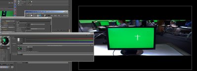

it seems as is something goes wrong with the c4d-backgroundobject no matter which fileformat or resolution i use: the rendered result is always stretched as you can see in the attached screenshot ( R14; latest octane-beta)

hi,
how do you use background?

hi,
it is just the standard-background object with an (sometimes animated) texture. normaly i use the backgorundobject for matchmoved/tracking shots. or if i need to adjust a 3D-element into a still image. at the moment i just try to figure out was is possible or not possible with octane concerning compositingstuff in general

background image will be sized to render output size. if you set lock resolution to specific size it will be match.

hi aoktar,
this is exactly what not worked in my case: projectresolution is locked in the octane- liverviewer, projectresolution is machting the native resolution of the texture/video/image in the backgroundobject (1080p) but in the octane -liveviewer the backgorund looks always horizontalley stretched as you can see in my screenshot. i ve been using the demofile " backgorund and matte". for this test.

hi aoktar,
here is a testproject.i think this strechting-issue is a bug or do i something completely wrong? another issue with backgroundobject: is slows the editorspeed a lot. just move with the camera around the cube. its lagging. if you delete the backgroundobject everything is fine.
