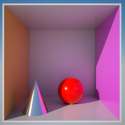

I made many test with Octane to render a real unclamped image. And, I haven't the solution yet...
I made a simple scene that I rendered in DL+Direct (Camera response : Agfacolor_Futura_II_200CD), and I saved one in tonemapped and the other is untonemapped (the both are saved in exr).
There are 3 images : Ok, for the moment, there is no problem
Next, I configured my read node in Nuke to read the file in sRGB : Image 4 (tonemapped in sRGB) and Image 1 (print screen) are exactly the same.
But first problem : The renderings aren't the same. Image 5 is more luminous than Image 4...
And that's not all : There is no color value upper 1, even on Image 5 which is untonemapped ! => Clamping :/
So, I tried an other solution to convert linear file in sRGB in nuke. I used the Colorspace node : 0k, Image 6 is exactly the same as Image 1.
And Image 7 has no pixel error on the sphere (for example)
Furthermore,the untonemapped image are color value upper 1
BUT, The renderings aren't the same. Image 7 is more luminous than Image 6... :/
Finally, I tried a last node in Nuke named "OCIO File Transform" (http://opencolorio.org/index.html). This node reads a file which convert linear files to Agfacolor files (http://code.metager.de/source/xref/blen ... _200.spi1d) : Images are visually the same with OCIO node and Colorspace node. But the supers whites (untonemapped files) have not the same value...
So my question is : Do you know a way to have exactly the same image Tonemapped and Untonemapped with unclamped value ? I would like Image 1 result with color value upper 1 in the specular... Please
