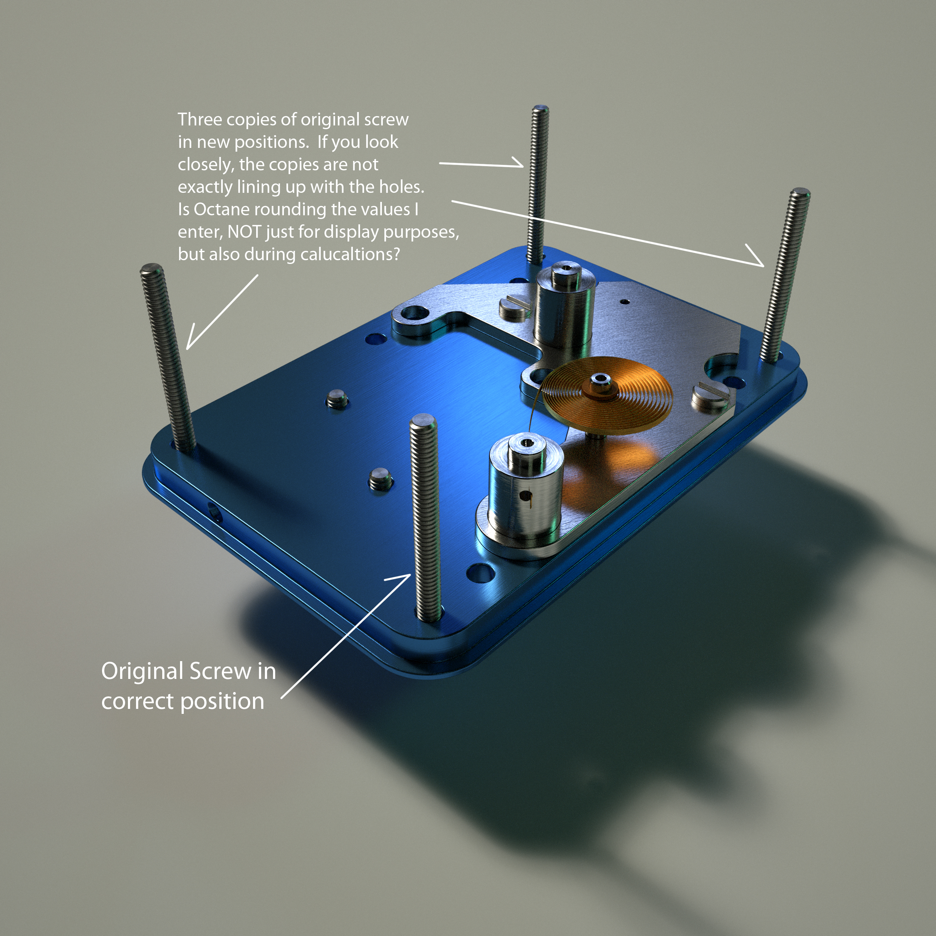

But please see my other thread, "Xform Nodes not working?". In that scenario, I am not translating back to the origin as we discussed here. I am letting the part come into Octane in its desired position. Then I scale it to the desired size. This will also scale its position coordinates in the scene. For a copy of that part, I then do a rotation and a translation on that copy, to get the part into some other location at a desired angle and position. Something is happening in Octane that makes the new position slightly off. BUT ONLY WHEN THE PART IS SCALED. If the part is just left at 1:1 size after import, all seems to be OK.
Please see example below:
