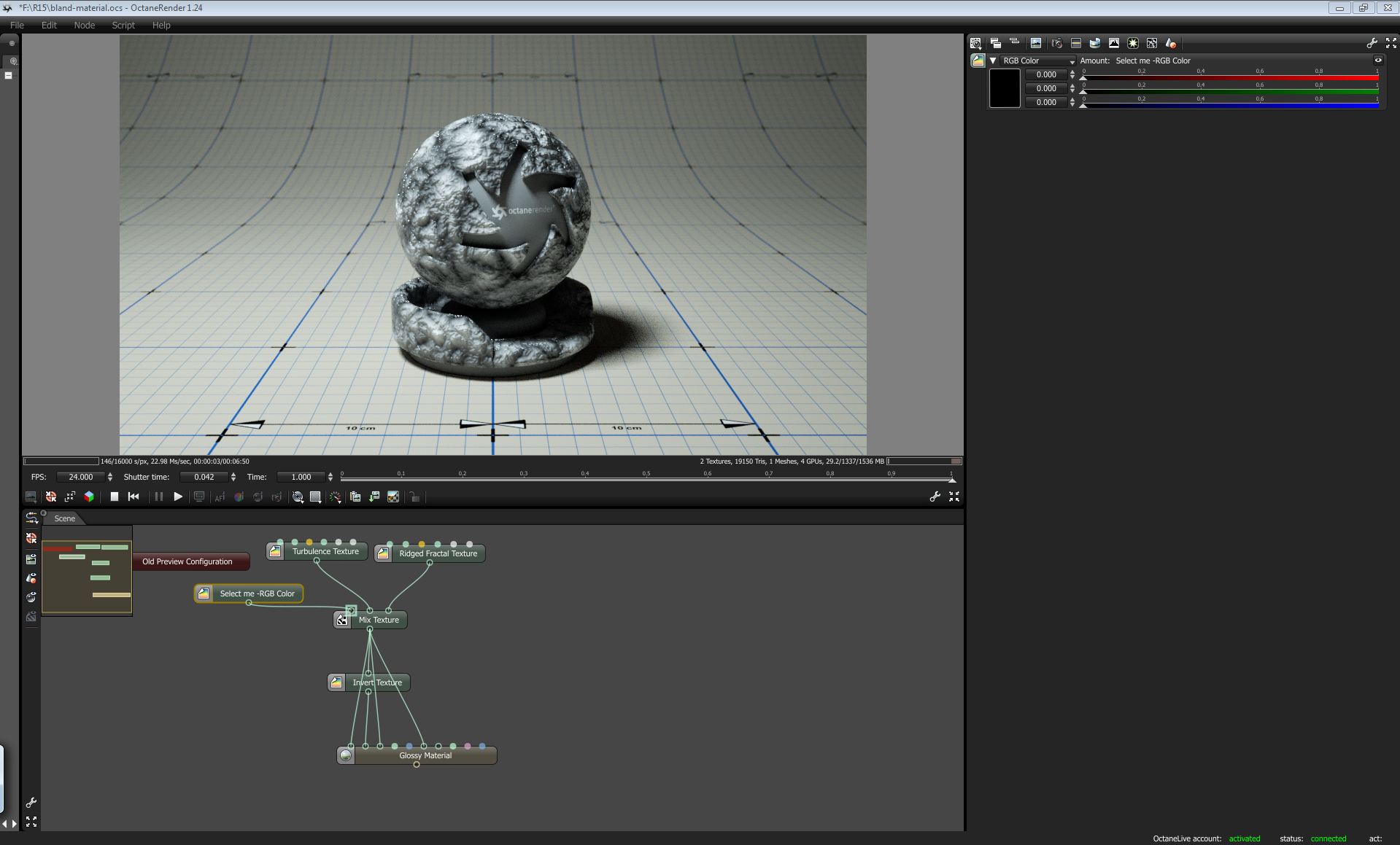

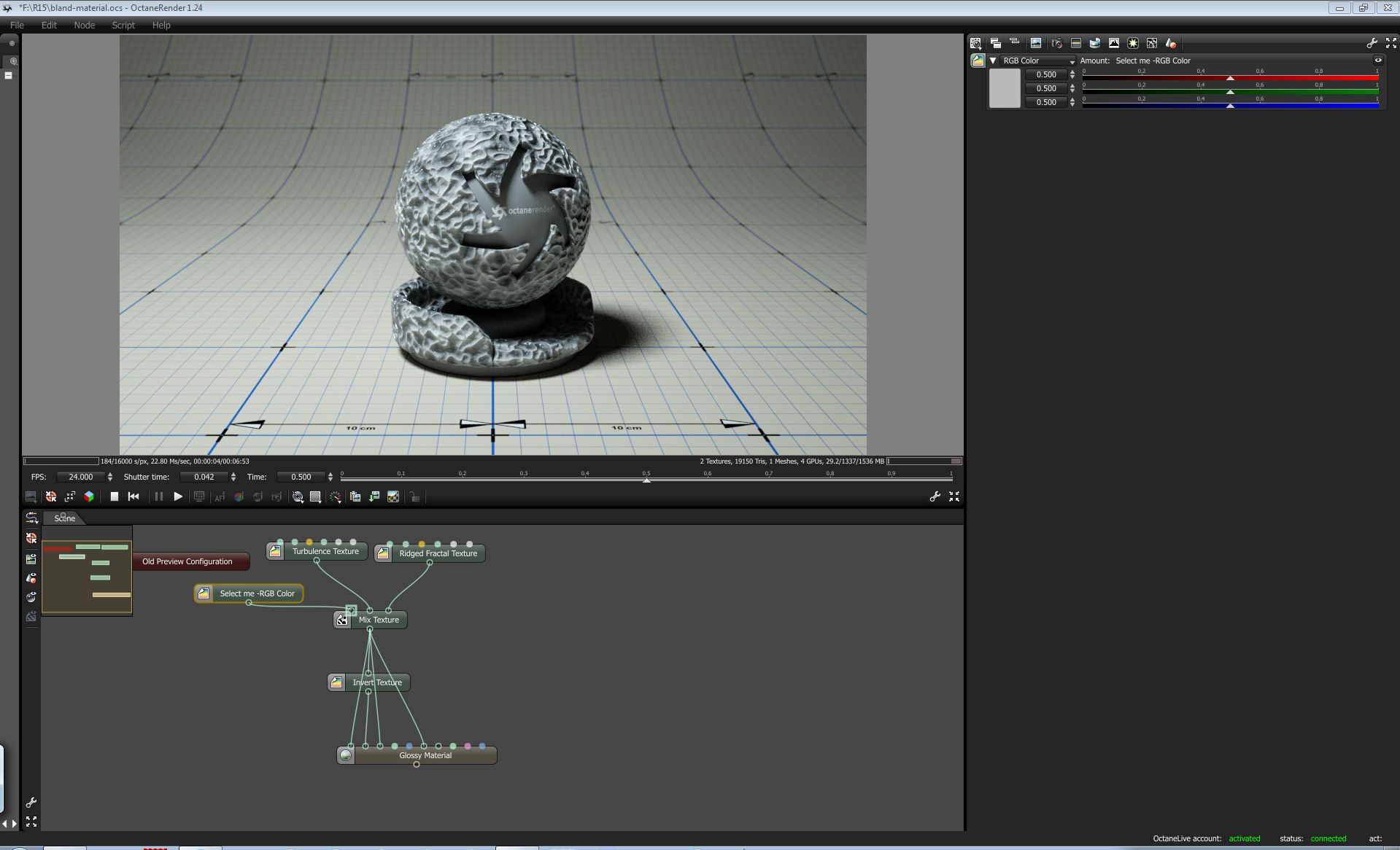

Posts: 10646
hi rikk, great request, now we are able to make material blanding easily ;)
first of all, a big thanks to thomas for the script :) i have changed the color blanding from white to black so what is needed is only to assign an rgb node to an amount port of a mix texture or mix material node. select the rgb node and run the script and voilà... blanding materials in standalone :D
lua rocks :D
ciao beppe
