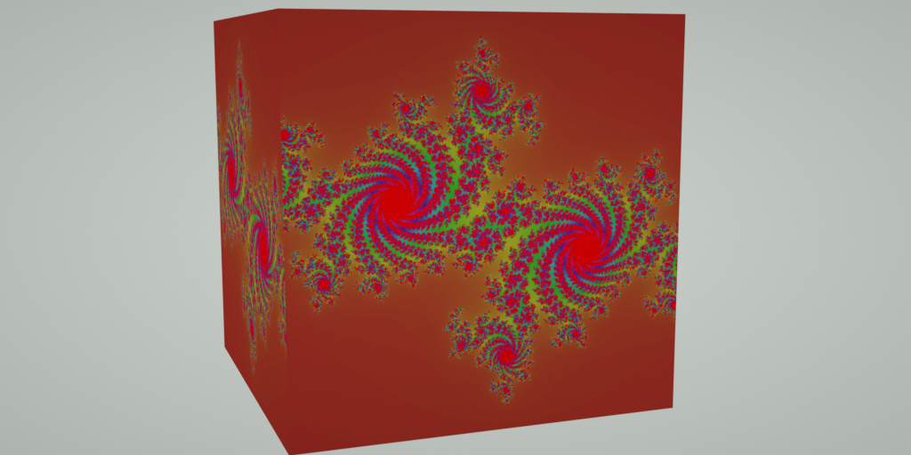

Here's a picture of the generated texture:
The julia set generated in Lua
cheers,
Thomas

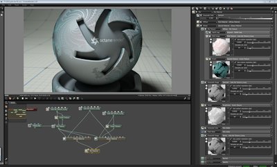

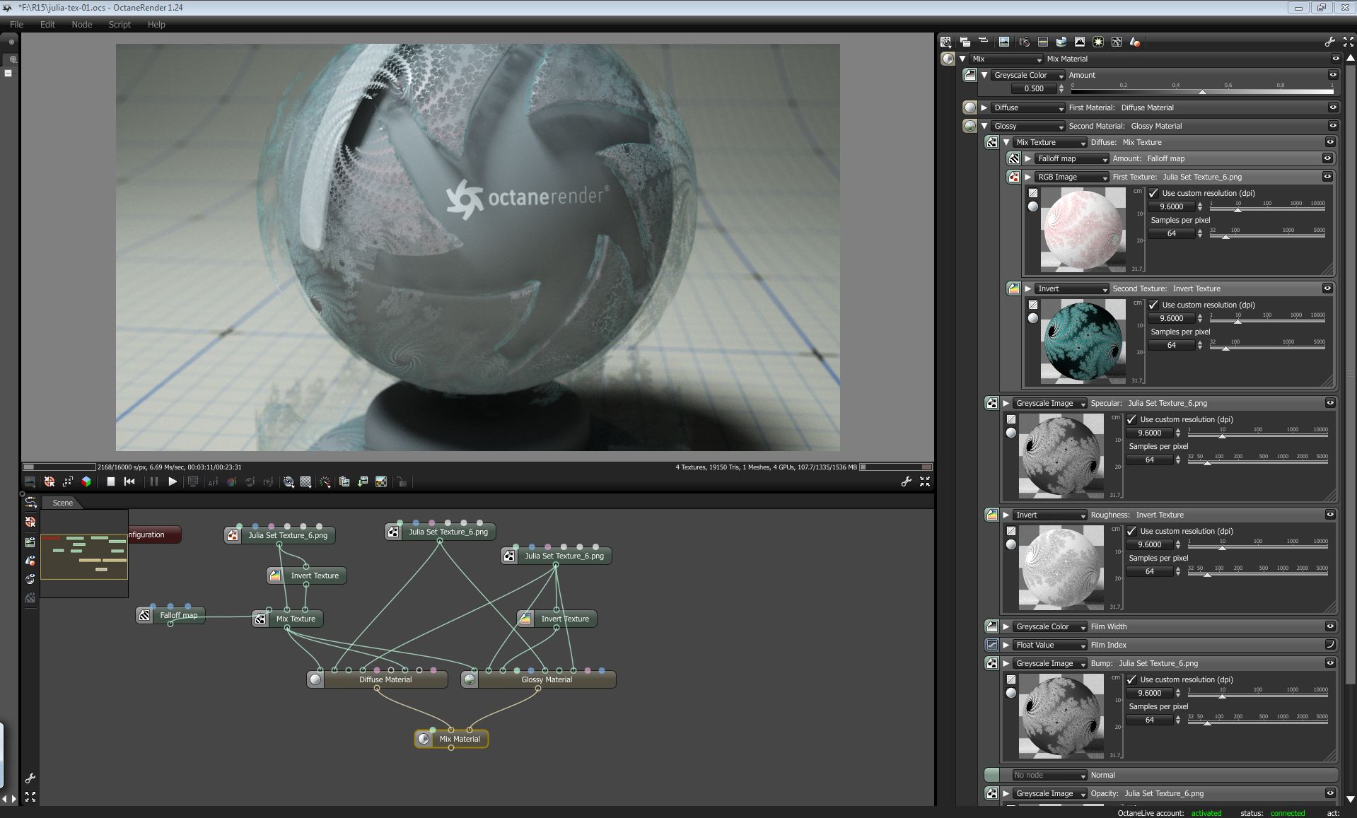

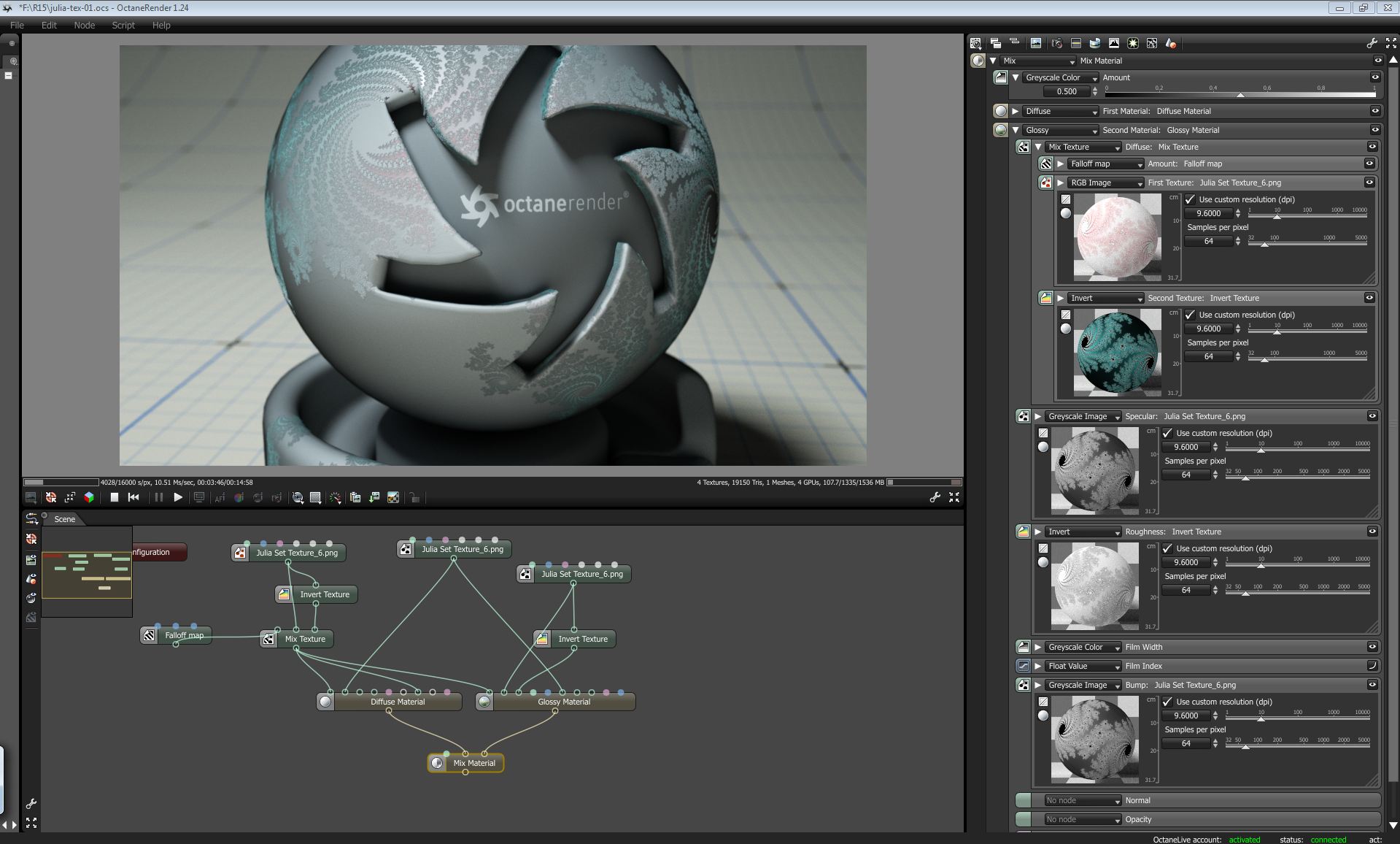

Posts: 10632
wow, this is great :D
for me is a jump back to the past :) the first 3d application that i have learned, some years ago, was Infini-D and there were only two kind of procedurals, mandelbrot and julia, no turbulance or other kind of noise. and i always used julia the most, so, thanks again thomas ;)
it remember me Kei's Power Tools by Kei Krause and Bryce 1.0... if someone will create an interface for fractals generation in lua, we will have the power of bryce inside octane when the displacement will arrive :shock:
here is julia in action ;)
ciao beppe
